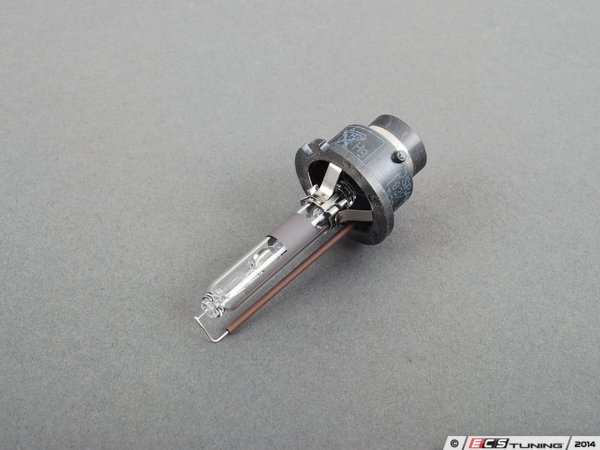

-7/2004 Xenon take the D2R bulbs. 63126907495 Replace in pairs so X 2. One for each headlight.

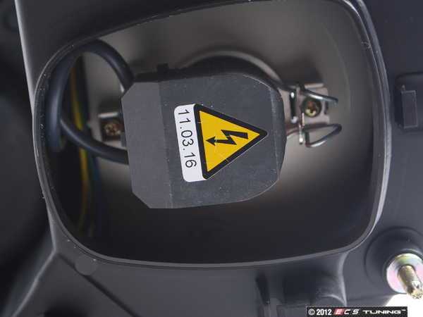

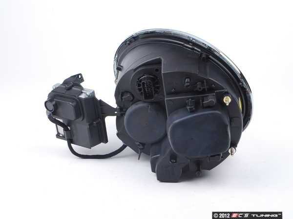

Then take pop the hood, car off and headlights off.
Go to the back cover and pop it off.
With it off you will see the ignitor harness, unplug it and then unclip the holder for the bulb itself. See the prong clip .
Dont touch the new bulb glass, just replace in reverse.

You don't need to remove the whole assembly to change the bulbs. Open hood, look behind headlight, open rubber cover, unplug connecter, open spring retainers, pull out old bulb. Reverse procedure to reinstall.
