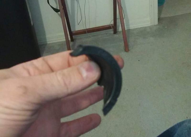

Well, I changed the belt, because it was pretty cracked, but all the pulleys seemed fine. Started her up and it still was making the sound. I tried to locate the sound better, since I had someone to help me, and it sounds like it's coming from the front, near the supercharger. I pulled the turbo inlet tube and found over half of the gasket on the turbo side missing. I'm guessing that this was the cause of the problem, and just ordered the line.
The thing I'm worried about now is, if the missing part of the gasket got sucked into the turbo, what kind of damage am I looking at? I didn't get any cel codes or other errors, and I didn't notice a loss of power. I did just notice, however, that the corners of the blades are all chipped off. I'm really worried about this.
Attached Thumbnails Whirring sound on right hand side 2010 MCs-received_628560303944956.jpg

Are the blades actually chipped, as in uneven? I'm not sure about in the MCS, but some blades are made with odd contours around the corners sometimes.
If the blades are in fact chipped, I'd look into replacing the turbo and maybe having a mechanic check the cylinder walls and such with a borescope. Or at least doing a compression test to see if there might be any damage to the sealing surfaces.
On the other hand, I wouldn't expect plastic to do a whole lot of damage to the metal internal bits, and would think the odds are reasonable that the blades could escape without major damage.
When in doubt, show the bits to a pro and ask for advice...
