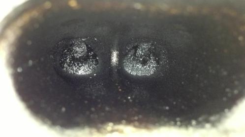

When seeing through the intake manifold hole (after disassembly) what exactly will be in view?

Something similar to this picture:

And it should look closer to this:

Those pics are from an R56S?

Yes they are

The above two pictures perfectly illustrate the issue with carbon build up. Can't get away from it, just have to include cleaning process into the service schedule. Mine were exactly the same before cleaning.
