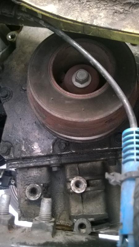

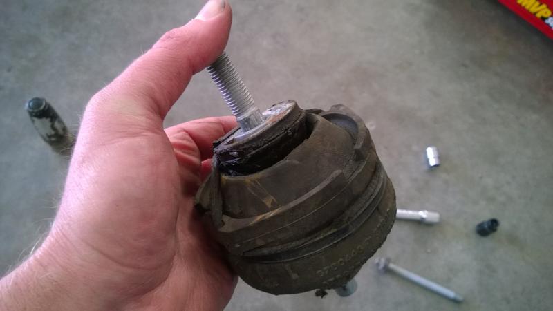

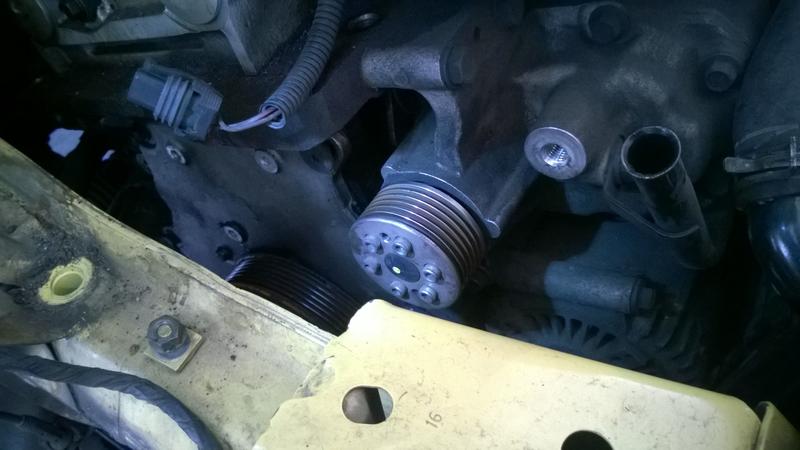

Changed the belt tensioner and I found some new issues. If you refer to the pictures, it looks like one of the motor mounts is shot.
I'm guessing I have a 15% pulley, but does anyone know who makes the one you see in the picture?
Lastly, is there a seal under the crank pulley? If so, I think its leaking.

If you wipe the dirt off the end of your pulley...it SHOULD have a # stamped on it for a reduction...most brands do anyway.

That's a Helix pulley. I don't even need to see the picture to tell you that, at your mileage, your motor mount is shot (unless you replaced it within the last 20-30k). That moisture under your crank pulley may indicate a front seal leaking, but it's more likely that it's your oil pan gasket. Get a flashlight and look for moisture under the crank pulley. As you've now discovered, things that leak on all R53s include but are not limited to: oil pan gasket, crank sensor seal, all three power steering lines. It's part of the price of ownership.

Thanks to you both, I monitor every drip and smell , and search and read all posts related, but I was getting ocd about it all until I was vilified by what I found in the pics. Now I need to remove the crank pulley to get to the front seal right? Good time to replace it, huh.(if its not the oil pan gasket). Do you have too cook all crank pulleies to get them on?
