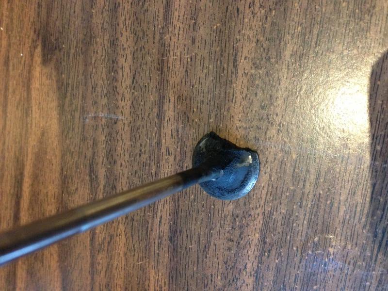

First time posting, but just curious about others experiences.
Have had my 07 Cooper S for 4 years now, driven over 50k miles with not a single issue until 2 weeks ago.
I was driving and felt the car "slip" and the check engine light started flashing and I lost about all power when pressing the gas pedal.
Also, on idle the car sounded like the engine was about to fall out.
Took it to the shop and they found that an exhaust valve had broken due to carbon build up (see image). This repair was not cheap by any means and I would like to prevent this in the future.
Any advice on dealing with carbon build up? Is this a common issue with these engines? What is recommend to help prevent this from occurring again?
I have already fixed the car and it is running great now, I am just looking for ways to prevent this repair again.

Typically carbon build up is an issue on intake valves, not exhaust valves. This is a little on the odd side...

I agree with the above, carbon buildup is not much an issue on the exhaust valves, but on the intake valves. Is the timing chain intact? Did it jump time?
Not to mention there isn't much carbon buildup at all on that valve.

That valve looks like one of mine did after a cylinder ate the sparkplug electrode in my R53.

Maybe it was the intake valves that had carbon build up. But the exhaust valve is what broke. It looks like it melted honestly.
The repair tech told me he was surprised the engine ran at all with the amount of build up inside. They went ahead and cleaned the engine while they were doing the re-build so hopefully I do not have to deal with this for a while.
The tech said to clean them every 50k miles, but I probably will head your advice and clean then every 20k.

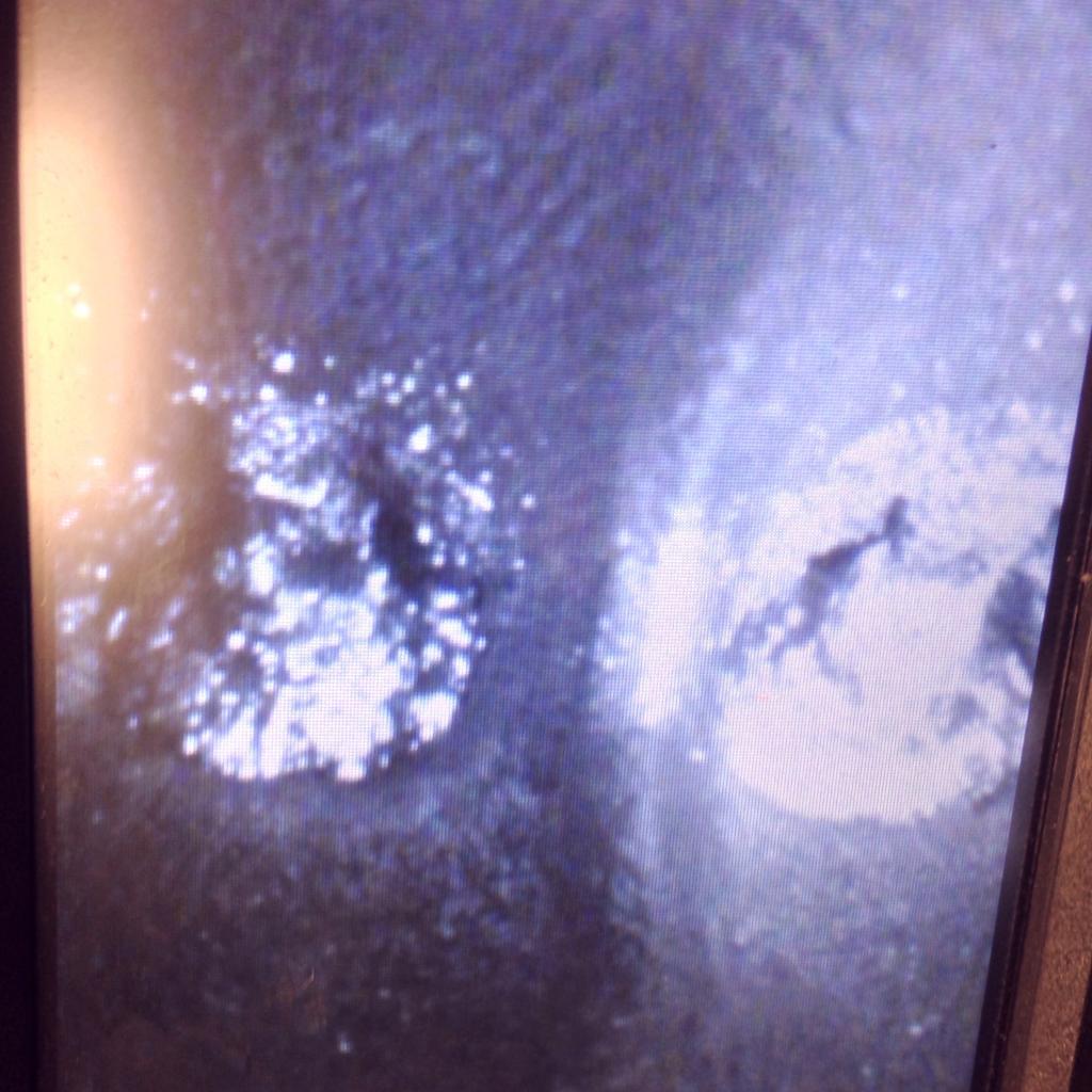

Here is a photo of my vales at 47k miles, look closer the there should be two vales there. Photo is from techs Snap On cam....The worst the dealer had ever seen. The tech went through 2 bags of walnut shells and was about to open a 3rd bag. I keep my car very clean and maintained and it was disgusting to see the pics. The car runs great now, but like you i want to avoid this from happening again and i'm not so sold on a catch can (several hundred dollar contraptions all the way down to a bud light can). The dealer advice....don't drive it so easy.
