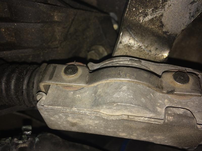

I just bought it a couple nights ago but it does seem like there is a bit of play in the gear itself. If i go to the actual transmission and manually but it in gear it seems like the shift cable is actually holding it a little too far forward. Theres another thing that's making everything difficult, there seems to be a clamp holding it down and im not sure how to remove it to see if theres something else messing up in the shift cables.
Looking at your attached image, there is an issue with the gear linkage. I have an identical one on my R50 2002 yet the second one is a different design. Mine is being replaced under warranty (yes I was surprised as well) as my car is 2nd hand and 12 years old and the warranty is by BMW and not the original dealer the car was sold in Australia by. There is a service recall on that linkage as it is known for issues with gear change, jumping out of gear etc. I am getting a new clutch on Monday and once I get the car back, I can post the Tech Bulletin ref regarding that linkage for you.

OK, located my paperwork, this may only be relevant to Australia.
Campaign # 0053368 Retaining clip on gear shift mechanism.
It appears to be something to do with an absorber so if the retaining clip is faulty it may mean the absorber falls out resulting in the linkage either jamming or not functioning correctly.
Hope this is of some help.
