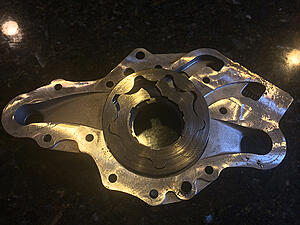

Found the culprit:
Help please! Strange engine noise (w/video)-zplrvtl.jpg

Damn, oil pump !?
Never seen one split like that before..

Odd too since oil pressure light was not on. What sort of debris in the oil pan ?

Yes, I'm still trying to figure out how it happened. My suspicion is that the inner rotor wasn't aligned properly with the crankshaft when I put the cover back on. The rotor looks like it has two opposite flat spots which should pair up with the flat spots on the crank.
That's just my theory, I'm not sure if the rotor can only line up one way with the crank or if the rotor self-adjusts...but it sure must have been quite a bit of torque to break something this thick!
Oh and the oil pressure light was on, but my initial thoughts was either a bad sensor or a needed reset since the engine was fully apart. I tracked it backwards looking at the filter first than taking the cover back off. I would've never expected the pump to die a violent death such as this.
