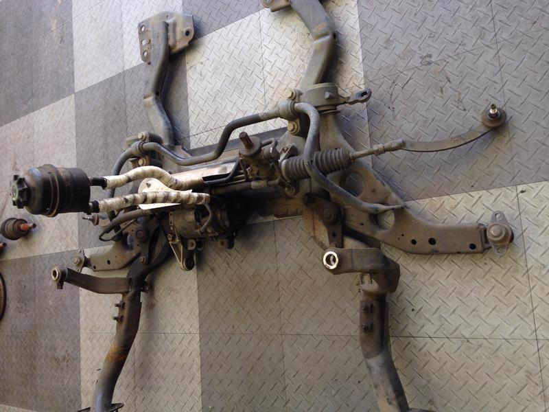

Anyway, when we put in my power flex LCA's we left the subframe on the car, he has a tool which is basically like a hockey puck looking thing with a threaded hole in it, just turn the bolt and it pushes the old bushing out of the bracket right on the car. Install new one is the same, just put the puck on the other side. The control arm itself was held in a vise while he cut the steel sleeve from the original bushing off the end, looked like an angle grinder with a cut off wheel.
By the way, I was hanging out and helping a few weeks ago, and he was changing a transmission, so he had to drop the subframe. He said it is easier to unbolt the powersteering fluid reservoir, and then disconnect the tie rod ends, and disconnect the end of the steering column. Taking the steering rack out with the subframe is easier than taking the ps pump off of the subframe. See picture, it's a simple compact package. He put a transmission jack under the subframe, and on a lift with air tools we had this out in about an hour or maybe just a little more.
