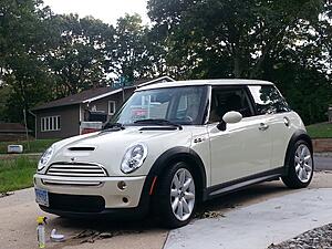

Hey guys, I own a 2005 MCS. 90k miles. Some strange noises are happening.
(picture if anyone is curious. Belonged to a family friend named Max. If you're still reading these forums, thanks.)

Nice looking R53! I can't tell from your post if it is a 6sp, or an auto, but for the engine speed-related noise, i would start with: clutch issues (throw out bearing). Does the sound change when the clutch is pushed in/let out? Another thing to check is the belt tensioner. Theses items are more likely to be wearing out on a 90k mi car than the s/c. Also check the damper pulley. I dont know what these sound like when they go out (i think they just go KABLAMMO, and dont make much noise prior to failing).
