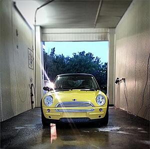

Hello all!
New 2002 R50 Cooper owner here.
Liquid yellow!
