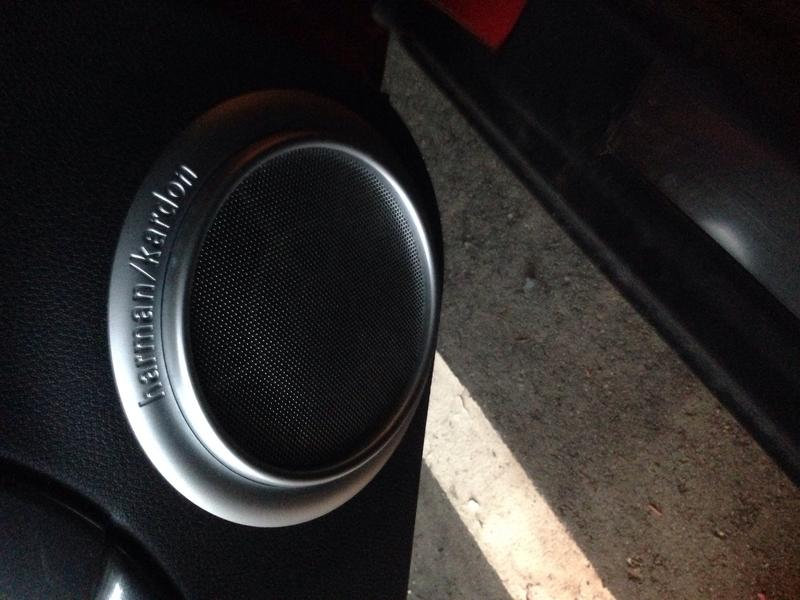

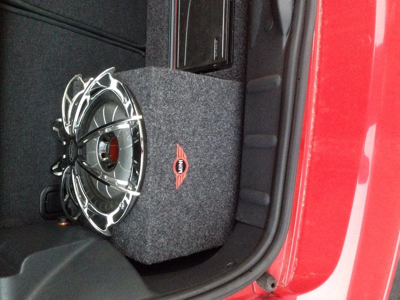

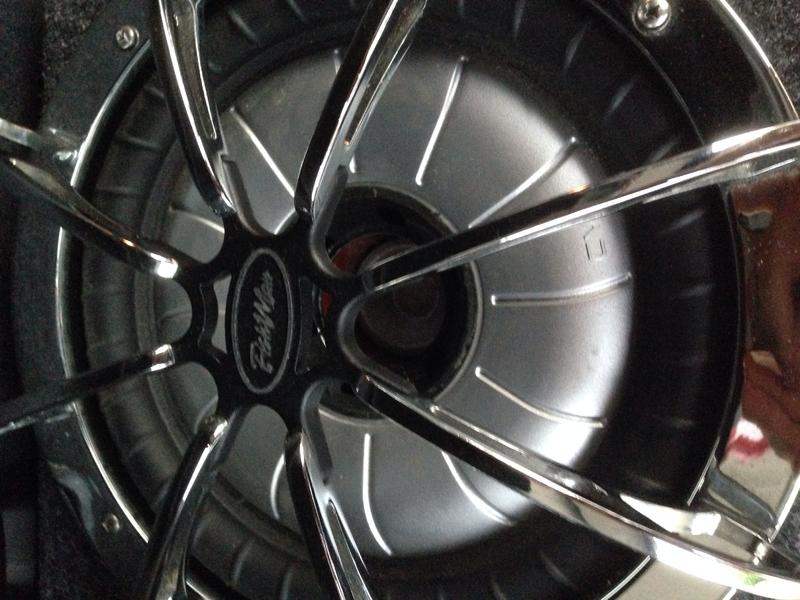

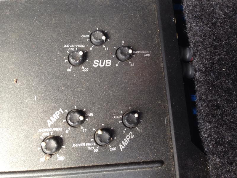

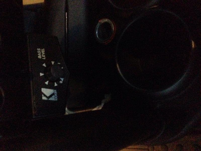

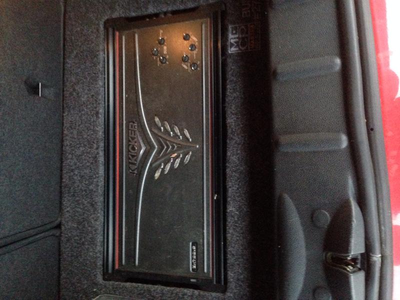

I basically assumed the kicker amp and speakers were part of the H/K system since the subwoofer in my car has a mini logo engraved on the box and a kicker amped sealed into the back floor but H/K speakers in the front. I have attached pictures of everything. Including the bass dial in the front (by kicker), the H/K speakers and then the AMP and Sub in the back.
To answer your questions guys, The battery connection and alternator are good to go, and as far as cracks, or cutting out or anything like that...absolutely zero signs and the sound system worked very nicely it was just draining the battery.
Here are some photos guys, I am interested to see what you think as I now have no idea what to do now!
Here are a couple that I described in the previous post. I am currently reading through some of the links you so kindly provided!

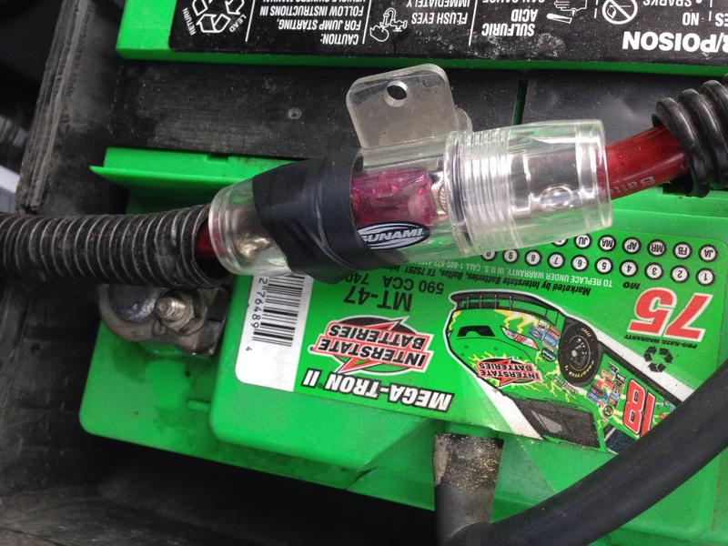

Can you check to see if there is a large can-shaped capacitor in there? Do you own a multimeter and can you measure the AMP ON wire at the kicker amp? Does the amp say if it is mono or multi channel? Does it have the MINI Head unit?
Ok so we probably need to figure out how the amplifier is powered up. There is normally a signal called AMP ON from the headunjt that makes the amps start. It may however use some funky new audio sensing, so have a look at the wiring of the amp power inputs and snap a pic to share.
Ah, that's what I figured, aftermarket set up on stock HU. Yea time to track down the drain on the kicker amp.
So i took a few pics, I think they may be the capacitor (attached Image) and I also took a pic of the amp as it does not list anything about multichannel...etc. Unfortunately the amp is sealed into the floor and I have zero tools...not even a set of sockets ( I know I know...time to step my game up). Luckily I got in contact with a decent car stereo shop and they are going to get my car in on Friday afternoon for some diagnostics!! I will keep you guys updated!!!
