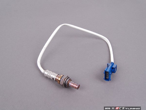

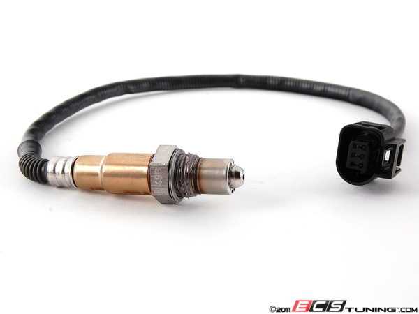

Don't know if you are out of warranty already. But here is the parts for the 2011+ R56 MINI Cooper S N18 engine . There is one before the Catalytic and one after the Catalytic, the code for "P2097" looks like after, post Cat.
After the P code it should say on the scan, bank 1 or bank 2. Bank 1 is the upper pre cat, bank two is the lower post cat..
#1 Oxygen Sensor Part # 11787576673 Pre Cat
http://www.ecstuning.com/Search/SiteSearch/ES254259__ES2587942/
OR
#2 Oxygen Sensor Part # 11787548961 Post Cat.
http://www.ecstuning.com/Search/SiteSearch/11787548961/
