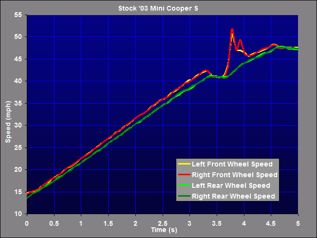

For straight-line traction, I've found the stock open diff to be pretty good at evenly distributing torque between the front wheels. The equal length driveshafts no doubt contribute by eliminating torque changes due to suspension travel.
That said, I've driven LSD-equipped MCS and they offer much better acceleration when coming out of a corner. There was a great article in last month's GRM that compared the different types and brands of differentials in detail.

Not sure about your data there Andy, but prior to my quaife install straight line acceleration was strictly a one wheel peel. Since the LSD I find I have a much better start off the line, and can apply a greater amount of throttle, especially with the sticky Azenis.

My logging agreed with the black stripes on the road.
If the mu split (difference in coefficient of friction between left and right tires) gets big enough, then one wheel definitely spins. But in my experience in most straight line conditions on both street and strip, both wheels spin about the same amount.
Would that be with the stock differential? mu split, friction coefficient and I thought this was an easy question.
Old Jun 2, 2004 | 10:54 AM
andy@ross-tech.com's Avatar
andy@ross-tech.com
Joined: Oct 2002
Posts: 3,652
From: Lansdale, PA
Yep, stock differential.
