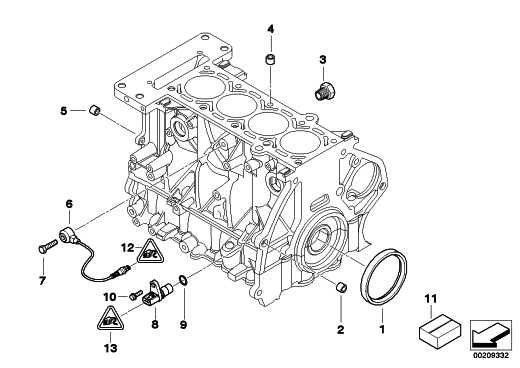

To drain the remaining coolant from the system, from underneath the car, there is a 14mm drain plug located at the rear face base of the cylinder block adjacent to the starter motor underneath the exhaust manifold heat shield (if looking down at the engine). It's located about 4 to 6 inches above the bottom of the block (where the engine block meets the oil pan) and between two of the large round press-in freeze plugs in the block. Don't touch the freeze plugs! Hope this helps.

Old Dec 18, 2013 | 10:15 AM
minibx's Avatar
minibx
Joined: Aug 2012
Posts: 1,056
From: Bronx,NY
# 3
Attached Thumbnails Heater Core swap...Bently instructions. Really?-image-316180750.jpg
