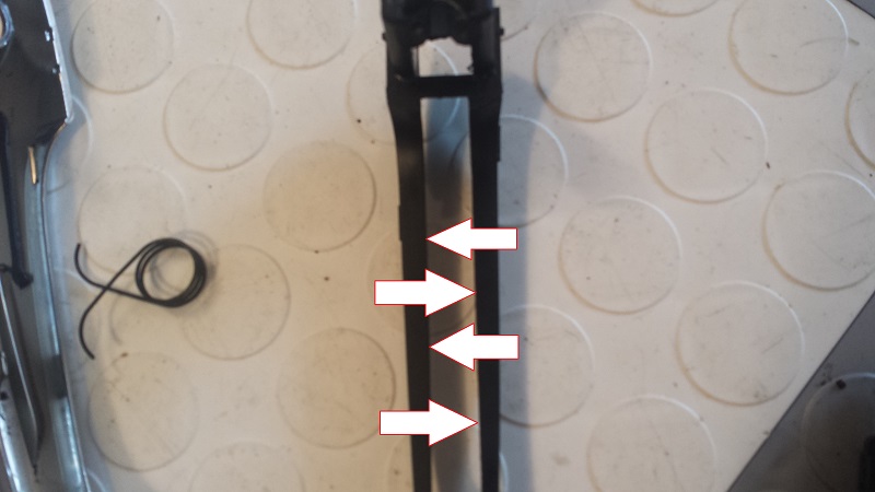

Originally Posted by mandd
I'll add my experience here, maybe it will help someone, and maybe someone can help me.
I have an '06, so the newer handles. I've only had the car for 5 months and it came from Southern California so it doesn't have a frozen history (I'm in Minneapolis).
I've found that when it is cold, the black rubbery part (the part you squeeze) goes into the chrome handle, but doesn't come all the way out. And it is very hard to squeeze--it gets harder as the temperature drops. The door opens fine, but the black part doesn't come all the way out. The door also closes fine, and you can open it from the inside too. UNLESS the automatic lock are triggered. Then I am stuck and can't get out. I have figured out that I have to make sure to pry the black part out before I close the door in order to not get stuck (again) Since I have the new style latches at least it is easier.
I've taken the door apart and taken the latch off and sprayed the cable with lube, and worked the latch until it seemed good. But this was in a warm(ish) shop and as soon as it got outside and below freezing, the problem returned. I didn't do anything with the latch/lock mechanism itself. Is it possible that there is a problem inside it?
I have done some more work on this and I believe I have the answer--at least to what was causing *my* problem. And to clarify, my problem was that when I squeezed the black plastic (1) part into the chrome handle it stuck in there, rather than springing back, when the outside temp was below about 40F. After much testing with the freezer over the course of a summer weekend, I found that the cables were NOT the problem. The issue was that the black plastic frame (2) that fits inside the chrome handle (4) was contracting enough so that it restricted the movement of the...um...squeezed part (the moving part of the handle (1) ) so that the spring tension wasn't enough to move it back to its 'neutral' position. The solution was to file the plastic opening (as indicated by the arrows in the 2nd pic) a bit so that it was no longer restricting movement. It worked after being in the freezer, and now that it has gotten cold again, it has been working down to about 15F.
Attached Thumbnails Drivers side door wont open!?-20140830_152329a.jpg   Drivers side door wont open!?-20140830_152355a.jpg
