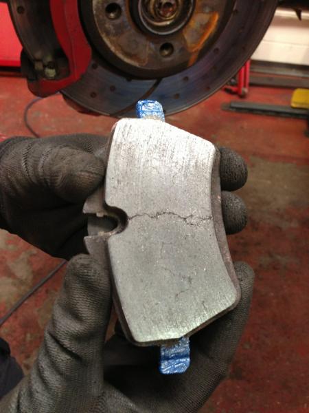

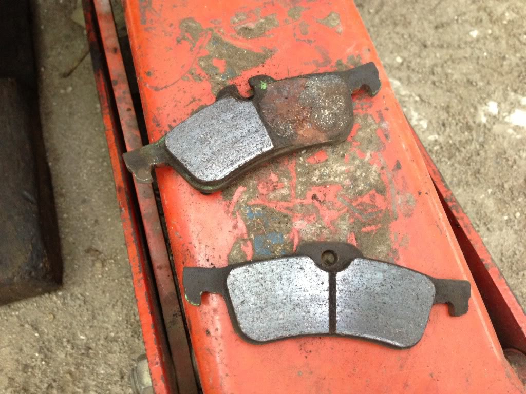

My greenstuff rears failed a coupla weeks ago, a good 2 days before our group run. Felt so blessed. Google: EBC Wake up!
Posted here:
http://www.minitorque.com/forum/f25/...solated-37402/
Some pics:

Originally Posted by minsanity
My greenstuff rears failed a coupla weeks ago, a good 2 days before our group run. Felt so blessed. Google: EBC Wake up! Posted here: http://www.minitorque.com/forum/f25/...solated-37402/ Some pics: LH side: RH separated upon removal: Mintex also fails: Look for some old fashioned riveted pads.
In that first picture it looks like the pad to the left was installed backwards because it has rotor wear on the backing. And if that's the case that would if put a lot if pressure on the other pad creating too much heat for it's design.

Likes: 25
Haha, not backwards, TG. What you see is where the pads used to be glued on. Pads separated & disappeared on a scary downhill drive. Having pad gone, it was hitting the rotor, hence that shiny mark. Won't take offense.:D
In all 3 decades+ of motoring, this type of pad failure was a 1st for me. Pads are changed coz they're due, never of failure. Ignored warnings about EBC as I found em good til that happened!
