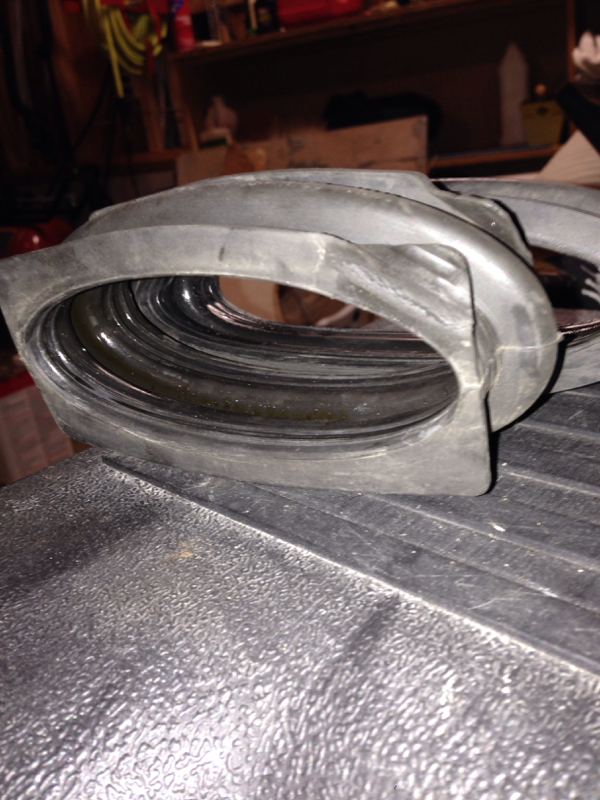

Couple weeks ago I had the EML light come on and it would go off with a restart of the car and it would do this every so often. Well, 4 days ago the EML came back on and then so did the SES light. The code found was P1498. I searched on forums and everywhere said to first check the intercooler boots. So I checked those and upon taking off the intercooler, I saw I had a bad fuel injector and also one of the boots was folded over and it appeared to not be sealed well as there was a fuel smell in the boot and it was shiny. This makes me believe the fuel had gotten into the boot and an obvious leak. I plan to replace the injector soon, so I put it all back together (properly) and take it for a drive with it seemingly running better. No lights came on for the 5-10 minute trip I took (usually the EML would have come in by then). So the next morning (today) I go to work and the EML came back on along with the SES. Same code was showing. Ugh!
Could the bad injector be the cause of the code?
Here are some photos I took of the parts in question.
Any help would be greatly appreciated.
Attachment 83154
Attachment 83156
Attachment 83155
By bad injector, I just mean it seems to be leaking.

Update: I have replaced the fuel injector o-rings and no more fuel leak. However, that EML and SES light are still coming on.
Should I just replace that SC Intake pipe? Everyone says that's what seems to cause this light to come on if it's not the intercooler boots.
