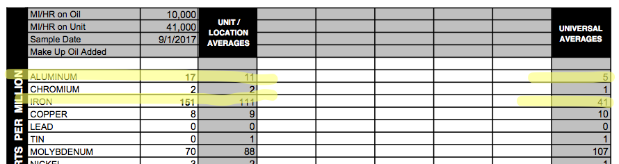

2014 N18 in a Countryman S, manufactured Nov 2013. It is now just shy of four years old. A few months ago I did the first non-dealer oil change. I took an oil sample and sent it to Blackstone for analysis. Here's the write-up of the result…
We're looking at a fair amount of metal here. Aluminum is from the pistons/bearings. Iron comes from steel parts like the crankshaft and cams. A longer run and spirited use can make add more metal than you'd see otherwise, but we're not convinced this engine is wearing as well as it should. It'd be a good idea to try a shorter run and see if that can help bring about some improvements. There is some fuel, but 0.5% is harmless. No coolant or excess dirt is present. Oil filtration is working well (low insolubles). Try ~7,000 miles. Check back to keep an eye on wear.
Oh, and I had to add oil part-way through the interval.
N18 engine isn't as effed as the N14 was, but I have real reservations about its longevity. Maybe my wife would like to trade her Countryman S for a WRX hatch…
