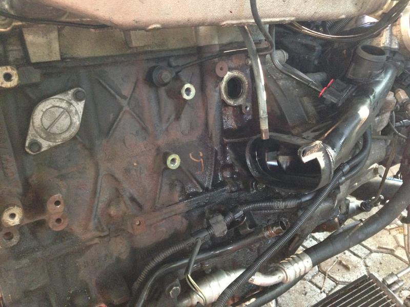

Saw that it was leaking from the short 4" hose that is connected to the lower bleed valve that connects to the water pump.
#4 here:
I couldn't believe my eyes when I pulled out the hose. The nipple on the water pump was completely rotted.
You can see in the pics below how clean the hole is on the pump itself. Looking at images on the web it is clear that this nipple is pressed in and not welded in. It is made of an extremely thin aluminum and the bottom part of it that sticks in the water pump must have completely rotted away given that my buddy never changed the coolant (nor did the previous owner whom he knows).
So this is a lesson for everyone - CHANGE YOUR COOLANT!
Now the question is I wonder just how much damage there is to the car -
a) from the exposure to old coolant for god knows how long
b) from the current exposure by not having any coolant (thermostat out, water pump exposed)
Does anyone make an after market water pump that is way better than the stock one? At least in this particular nipple department? I just can't believe how thin and flimsy it is.
Now I have to take the whole front end off and replace the damn water pump. Joy......

Here's the hose as it looked after disconnecting the clamp! 95% of that aluminum nipple is in the hose. WTF!
Here in the top left corner you can see the smooth round hole where the nipple is supposed to attach.
I had to mangle the nipple (in terms of shape only) to get it out of the hose. It was extremely flimsy. But the edge of it was already mangled.

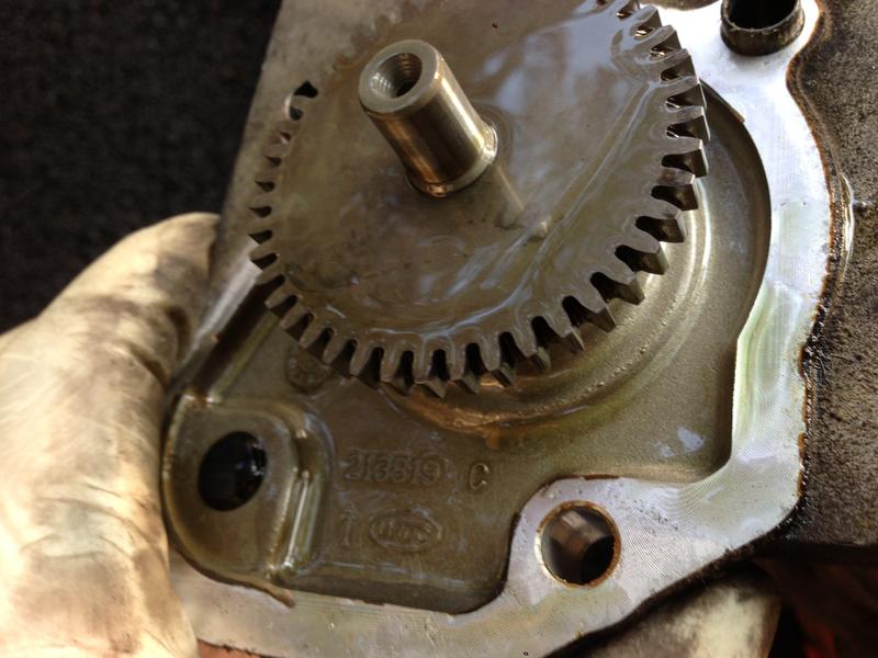

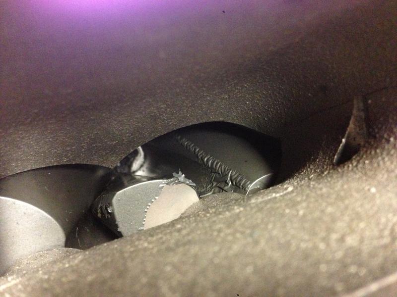

I just pulled the supercharger out.......
I checked the oil......on the water pump side......and it was perfect...But it stunk.
I rotated the pulley and I looked on the water pump side to watch the vanes....and the friggin teflon coating was PEELING OFF the supercharger vanes! The pulley required some force to turn and you could hear the peeled coating rubbing around.
Luckily I have a spare take-off supercharger in the closet. Going to pull it out tomorrow and make sure it rotates freely.
Wow crazy water pump failure there while heater hose. Supercharger got heated up there to bubble off the coating. Was there rotor to rotor contact/noise present too? Easier to see with the outlet horn off. Keep up the good old maintenance!

Yeah was crazy.

Drove the car and it was smooth. No rotor-to-rotor contact...just flaking teflon that I blew out with some compressed air as best as I could.
