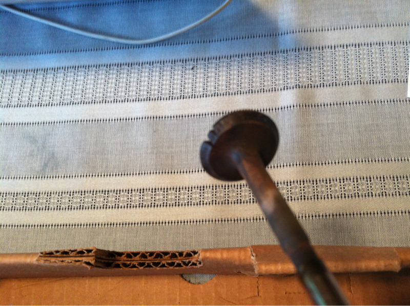

I got the head off today and found a burned exhaust valve in cylinder 3. The rest of the valves and the head itself don't look damaged.

The old valve in the pic below is the burned one from cyl 3. There were 3 other valves (the other cyl 3 exhaust and both cyl 4 exhaust valves) that were showing signs of wear, so they got replaced, too.
