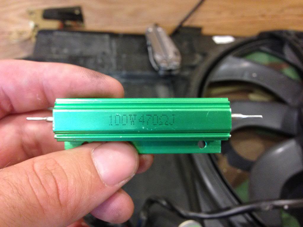

So i will obviously need a whole new relay. Big deal 35 bucks, ok i can drop that. But im not going to leave that just like it comes. I did some research and found a better beefier resistor that should (i haven't tried it so we will see work better and last forever. Here it is, a 100W 470ohm 5% resistor.
once i get the new relay i will continue the posts of the wiring and hopefully fixing. If any of you have feedback or ideas, please let me know

it probably melted its way through the plastic frame if he mounted it where it's shown in the first pic...

Per the cited thread, the correct resistor rating is 0.33 ohms, so that 470 ohm resistor won't work no matter where it's located.
