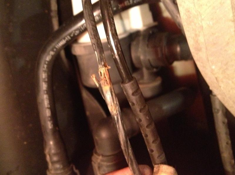

Victory today, as I was finally able to to clear the P1447 & P2418 codes on my R55 2010 (base) Clubman. A few weeks ago I tried replacing the vapor purge solenoid up underneath the intake manifold, but no luck. Next hunt & peck part was going to be the Leak Detection Pump (LDP) itself. But today, while replacing the rear brakes, including wear sensor cable, I found the problem. The wear sensor cable is bundled with the LDP wiring (and the ABS cable), and routed through a sharp-edged little metal clamp, snapped onto the right rear suspension member. While replacing the brake wear sensor cable, I just happened to notice that the LDP wiring was chaffed and broken! Two of the four LDP harness wires were compromised (pic attached). Repair required only a few cents worth of solder & electrical tape! Voila - codes cleared! Bitter-sweet really, as I'm a bit disappointed that 'wire chaffing' is a problem in this day & age. The car is only ~4-1/2 years old, with only ~64k miles. I guess Lucas, Prince of Darkness lives on, except these days he lights up the dashboard instead of going dark...

Image shows my chaffed & broken LDP connector wiring, found at the little metal clip tied to the suspension member at the right rear.

That is the same wire my dealer told me is bad, but mine looks fine right by the clip there. I have no idea where it leads to though, so I don't know where else to look for breaks in that wire.

To be clear, in my case, the damaged ldp wiring was hidden underneath the clamp. Essentially invisible, until the bundle was removed from the clip.

Many thanks for this solution. P2418, p1447, p2419 have been coming in on my 2010 Mini Cooper, and the fix was just as described.
I jacked up the passenger side rear of the car and pulled off the wheel. There, I could see the DMTL pump and related wiring harness. Two of the wires were nicked and corroded, right at that stupid clip.
Strip wire, solder and tape was all that was required.
I removed the clip, and put a zip tie around the whole bundle to secure the repair.

This is a view looking forward, after the right rear tire is removed. The rear brake disc is visible in lower left of picture. The nasty clip is mounted on the inside of the support member. You can see my defective wires ready for repair, just right of the red sway bar.
