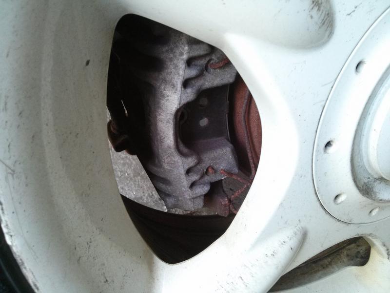

For one, one of the springs on the rear right brake caliper (the one that was squeaking) is broken. Looks like corrosion helped.

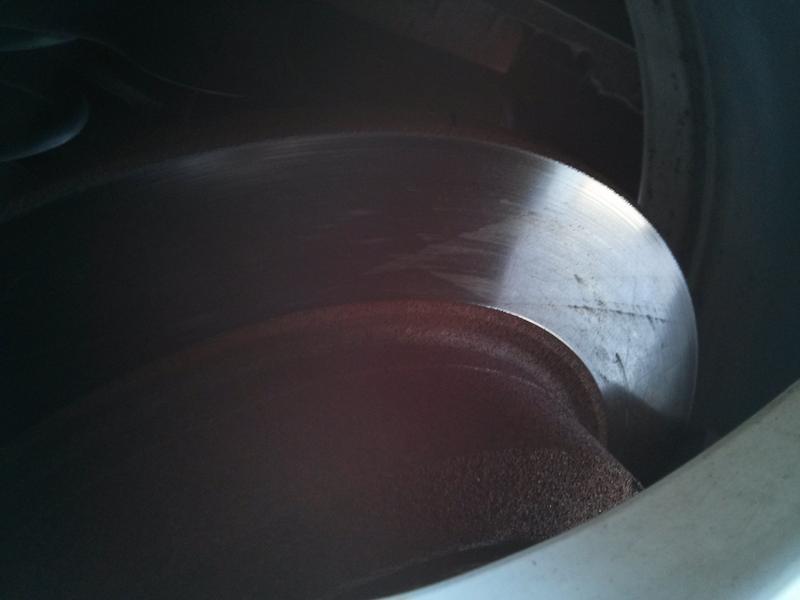

The wear pattern on that rotor looks really weird. There's a bunch of "streaks".

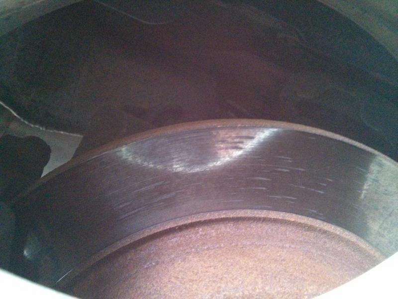

The wear pattern on the rear left rotor looks strange as well.

  1. rotor wear on the rear right
  2. broken caliper spring on the rear right
  3. rotor wear on the rear left

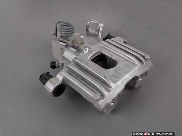

Here is the rear brake caliper . Up to 4/2003 production.
http://www.ecstuning.com/Search/SiteSearch/34216757247/
Rear left caliper.
http://www.ecstuning.com/Search/SiteSearch/34216757248/
Rear Right caliper.
Check the rear caliper out if your mechanic or yourself pulls it off the MINI.
The piston can stick over time and then have to be worked back it while turning it at the same time.
If it dust boot is deteriorated and corrosion is around the piston and cause it to stick slowly. There is no replacement seal from MINI for the inner seal. Just the boot.
Have not seen a retainer clip rusted that bad in a while. That's a must for replacement, do the rear left , rear right at the same time.

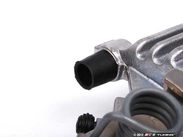

Another thing to check since you have shown some rust is the rear bushing guides. Rust can build up between the rubber and the caliper causing the slider pins not to move like they should. Pop the old guide busing out , clean the rust and corrosion out and then pop the new guide busing in.
One set for each caliper.
http://www.ecstuning.com/Search/SiteSearch/34111157038/ES59450/

from what I've read that outside spring is there primarily to stop vibration of the two caliber parts - so without it having good tension your caliber and pads are possibly floating too much. Not a hazard but I' put new ones on all around. {I've never see one rusted away like that - but I live in FL now thankfully!}
I don't see the wear issue - well I don't think I see it anyway, what I do see is reflections . . .

I got two new clips for the rear calipers. (The front calipers don't have any noticeable rust or corrosion for some reason, so I'll deal with them when I work on those brakes.) I also got new dust boots, the OEM brake pad grease, and the piston tool. Also ordered an electric vacuum for dusting.
I went aftermarket on the bolts/bushings and got the Tyrolsport metal bushings.
I'm basically just going to reseat everything and see if that doesn't help.

What I don't get is how the pics of my rotors could seem normal, I thought that normally worn rotors have very fine, concentric grooves kind of like a record, and that anything else was bad? In the first pic there's very large, concentric "streaks" all around the rotor, and the right side rotor has diagonal markings across it. Neither of the front rotors have irregularities of this sort. I know my photos aren't amazing, but I thought there was enough there to get a glimpse.

Sometimes one rotor might have more rust...so streaking, etc is different. ..park next to a sprinkler?
The rear rotors on my car DID Fail...severe rust around the edges...after about 40,000 miles....5 years of nh salt...but imo if you take everything appart to clean, and fix...spend the $20 on a new set of rear pads.....better ones are more, but I bet the pads are not wearing evenly...so reusing them would be a waste.

A friend helped me with this yesterday. We took off the rear/right caliper. We couldn't get the old clip out, it's bound to the caliper. PB Blaster didn't seem to loosen it. Tried punching it out from the inside of the caliper, and that didn't work either. The clip wouldn't come free from the top or the bottom of the caliper.
He has rear calipers with low mileage that have never seen winter that he might sell to me. Until then I'm riding with a busted clip. I didn't throw on the new bolts/bushings, dust caps or anything.
That said, multiple people/mechanics have remarked that my rotors/pads are fine.
