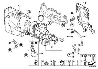

I'm no tech but my dealer has told me that to get to the wastegate you have to put the car in service mode, (remove the front bumper cover), move some of the radiator parts, drain coolant, and remove heatshield and catalytic converter.
The book rate for that is 5.5 hours labor. Just to inspect the wastegate. Here is a oem parts diagram of the turbo. I don't see a gasket for the wastegate.
Good Luck

Ugh - 5.5 hours for someone with the proper tools and existing know-how. Guess it's not something I'd be able to tackle. The service adviser said the oil filter housing leak was a pretty in-depth repair as well. Even if I fixed these two items, I'm still worried something else is just around the corner. The carfax report indicated the previous owner had the turbo replaced around 45k miles. After I bought it (around 69k miles), I took it to my local oil change shop and he brought me out to show me the oil filler cap - it was coated on the inside with thick, chunky sludge. He thought maybe the previous owner had not been using synthetic oil...

If the turbo was replaced by a MINI dealer it should carry a 2 year warranty on the part I believe (At least my dealer does this). Not sure how long you have had the car.
As far as the 5.5 hour book rate goes, I believe they are padded to the advantage of the dealer, but that is my opinion only.
The tricky part is when to pull the trigger right? In my case it's all that labor to inspect the wastegate. But for 2 more hours worth of labor I can have the turbo replaced. Although the turbo is a lot of money.
The point is that you pay for all the diag work, maybe make the gasket repair and then soon you have problems again which only leaves replacing the turbo.
That is where I am at as well. I think I am going to tear into it this weekend and at least try to prove that the turbo has to go or not.
