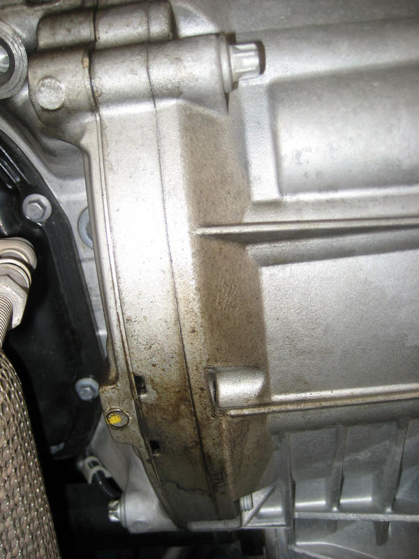

this is it guys, its after a hard drive so u can see that the oil is burned there but u can see some remainings of how it was spread
Attached Thumbnails crank gasket leak-crank-gasket-00.jpg   crank gasket leak-crank-gasket-01.jpg

Old thread, but someone isnt mislead, this is not a crank seal or RMS leak, but likely the oil filter housing or turbo feed line or both.
