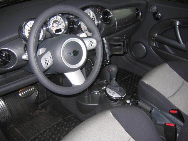

**But that's not the problem here, I would stop using the heated seat button on that side ASAP. You don't want it to ignite.
The only fix would be to replace the seat bottom. It looks like you have space gray cloth sport seats.
Picture of you seat type:
https://www.northamericanmotoring.co...d-interior.jpg
Here is the part number:
52107155058 production -7/2004
52107132568 production 7/2004 - 1/2005
Thanks and I hope that helps.
