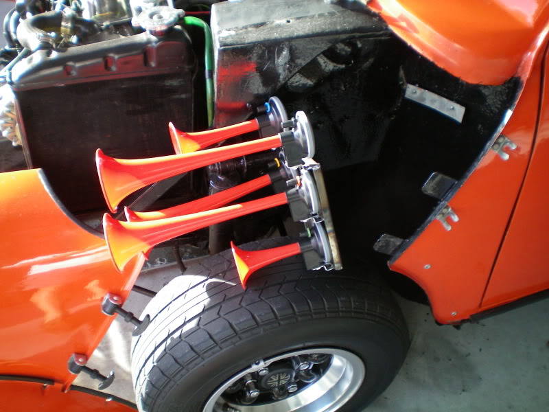

b. them ain't horns - these is horns
http://www.stebel.it/stebel2009/prod...logia=musicale
