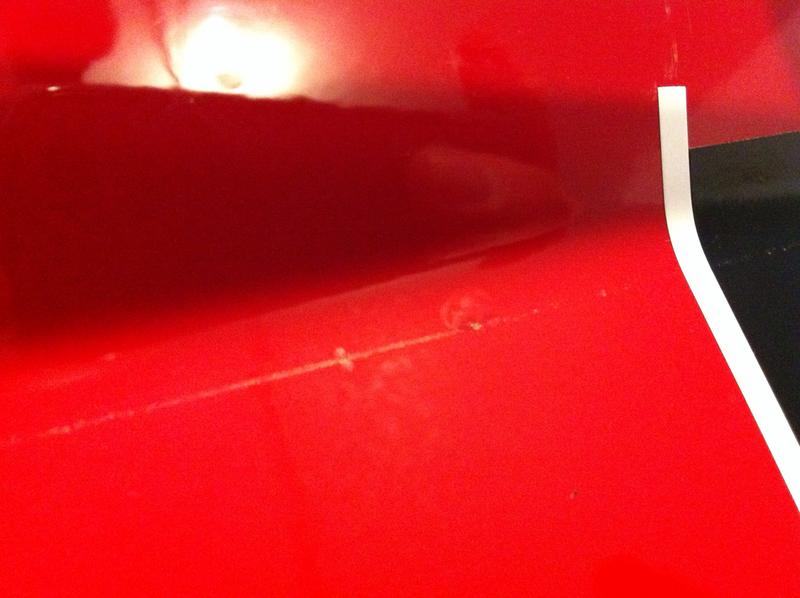

Hey everyone, I was working on putting on my racing stripes the other day and when I took off the chrome handle off the trunk I noticed two small spots where the paint is bubbling. Has anyone else has a problem like this? Do you guys think it's rust? The car is merely a year old... Also when the engine warms up I find at idle rpms and when you turn the car off it makes a rather loud squeaking noise. Any info would be awesome

Not a very clear picture... If it is rust it's covered under warranty. The squeaking sound could be a water pump, serpentine tensioner or just the serpentine belt. If the car is just a year old, take it in to be looked at. It should all be covered.
