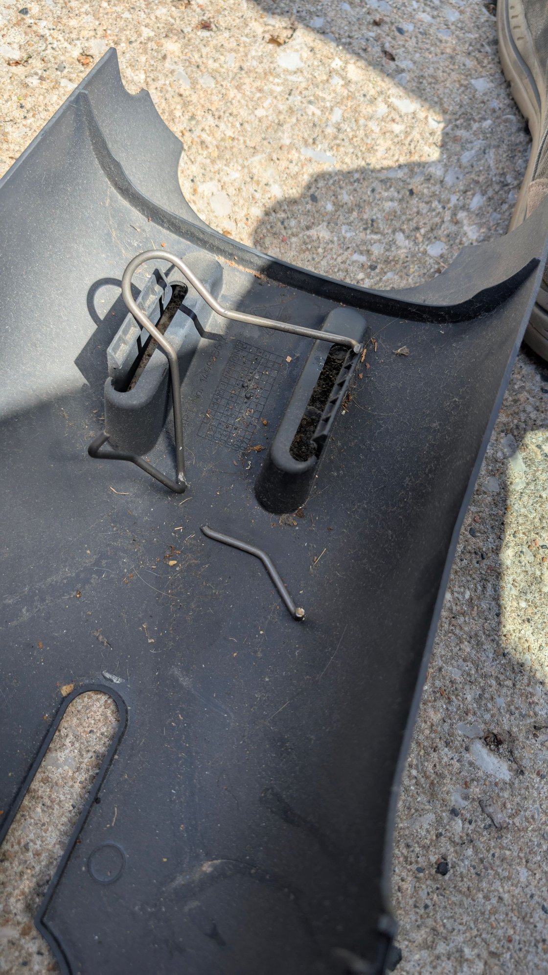

Broken spring
I tackled this loose tilt issue and found this broken spring under the lower cover. Anyone tell me where it goes and what it's for?

That "spring" is part of the tilt mechanism. Can be seen here intact

Your very welcome, does not seem as if this part is purchasable on its own as its part of the column assembly. You may have to find a local parting out an r50-r53, or order an entire column unless you can find this part on its own.

Thanks, Scoobaru! Does the spring just assist with raising the tilt steering? I got it back together without it and seems to function okay.

Yes I believe it's what locks the lever down, im not sure what other function it would serve to be honest. You should be fine without it!
