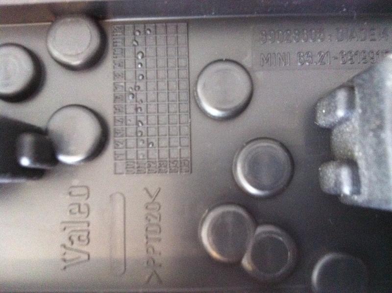

THANKS GUYS! Looks like this is what I have... I will order the parts soon. Sorry ive been MIA (just bought a new house and moved in) I do have some pictures of the bulbs.
Attached Thumbnails tail light Help please-valeo4.jpg   tail light Help please-valeo3.jpg   tail light Help please-valeo.jpg
Old Feb 19, 2012 | 01:15 PM
rkw's Avatar
rkw
Joined: May 2005
Posts: 8,233
Likes: 128
From: San Francisco
The part number 63216919915 is confirmed in the 3rd photo (second line at the upper right, where it says MINI 63.21-6919915).
Old Feb 19, 2012 | 01:39 PM
motoballer21's Avatar
motoballer21
Joined: May 2011
Posts: 8
Thanks again. I really appreciate your help! I ordered the part from Penske.
