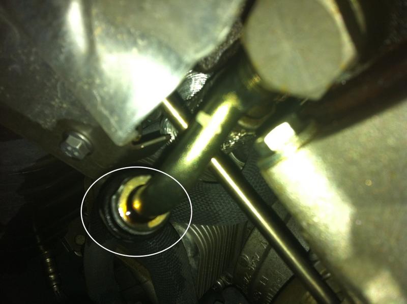

I noticed an oil leak today. Looks like it's part of the oil lubrication loop, but I'm not sure. Anyone run into this before, know how serious this might be? I need to schedule a service anyhow, just need to know if I should park it until then or not.

Turbocharger oil line; get it fixed ASAP.

What might cause such a thing?

If oil isn't pouring out with the engine running it should be ok until you get it to the dealer. Either the line cracked or a loose fitting could cause that.

Poor crimp and sealing construction on the oil feed line.

it looks like the oil return line, or even the water feed line with oil pooled on it.
