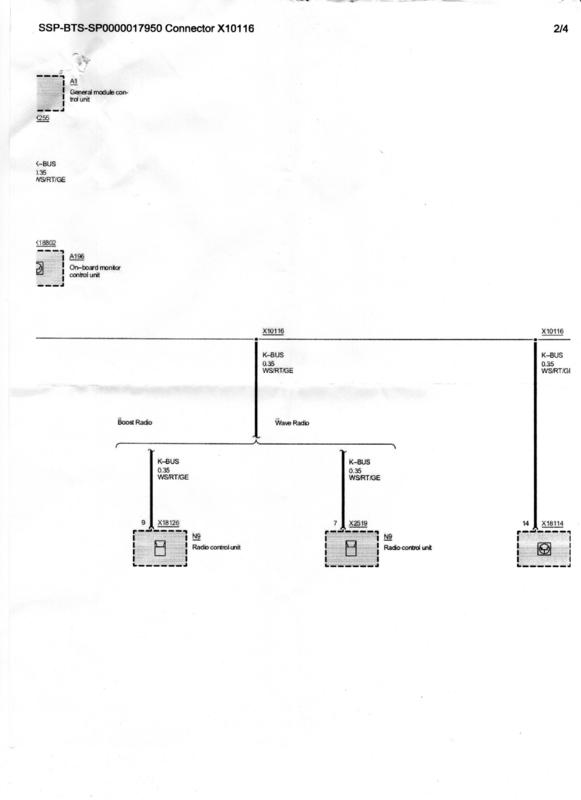

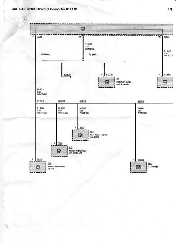

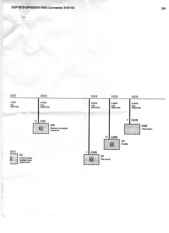

I just had this and solved the issue by disconnecting the CD changer. Apparently it was the cause. There are many things that can cause this. Any one will do it. Unplugging them one at a time is how my mini tech buddy figured it out. Problem was I installed the changer so he "knew" it couldn't be that (Because of the mini build sheet my vin generated) and did everything else first. He said it was the problem and removed it, but I don't know if plugging it back in would have been OK or not. At that point I am pretty sure he didn't bother to check if it was actually working or not, or if the fact it was not coded in the computer was the issue.
Here is the schematic.
Attached Thumbnails 02 mini with disable radio messge-scan068.jpg   02 mini with disable radio messge-scan069.jpg   02 mini with disable radio messge-scan070.jpg

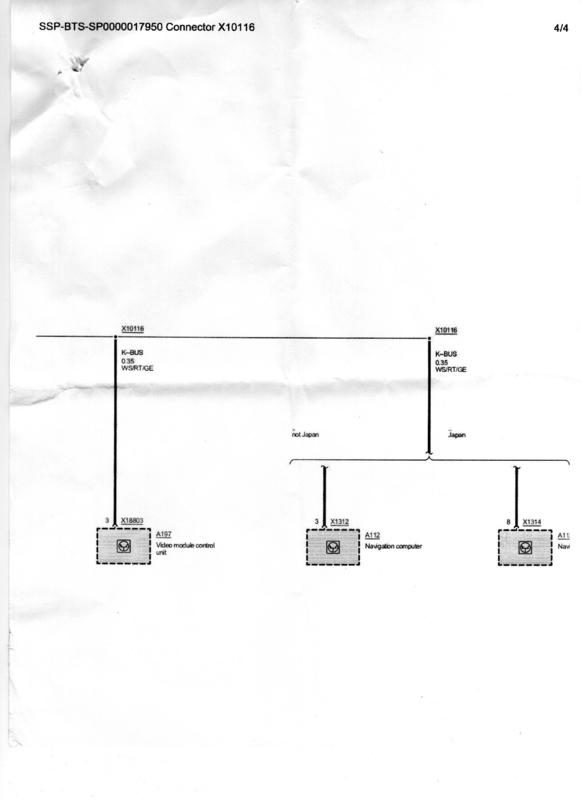

Then add this one...
