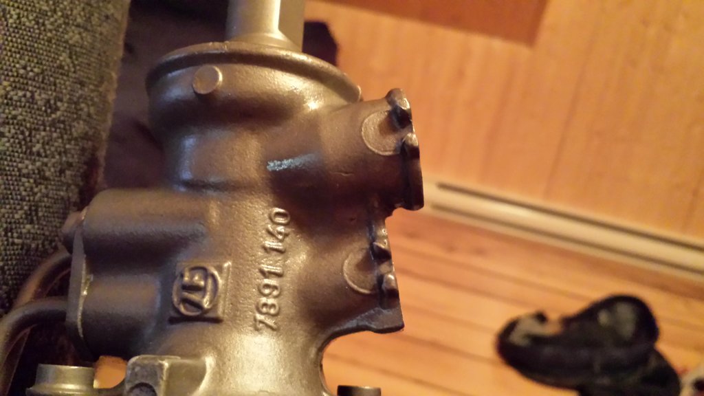

Originally Posted by jskeith111
what is "looping the lines" in the steering rack? I would love to convert to manual steering but would definitely need some help here.
Looping is simply connecting the 2 holes of the rack so fluid & air can pass freely from 1 side to the other when turning. Here are the 2 holes that need to be connected:
If you notice our rack doesn't have those 2 holes aligned on the same plane, so this e30 flat looping block won't fit on ours:

Originally Posted by Da_Ghost
I got my stuff today (fittings as well as an exhaust tip to get my exhaust finally done). I decided to give it a go.
http://imgur.com/a/BOLki
First impression: Where the hell is my turning radius????? Getting out of the parking was more of a challenge as my turning radius increased, a lot. My test drive wasn't really conclusive, something is definitely odd. As expected, it's a lot stiffer, but not as much as driving with a dead pump since you don't have to move all the fluid around. When my pump was acting up and not working, it was awful to steer in a parking.
I'm not sure if I simply don't have enough fluid left in the rack, but the lock-to-lock ratio is really out of wack. When driving it on the road it was fine, but when I came back home, I couldn't make it in the u-shaped parking, I had to reverse and readjust. I tried it again while parked not even an hour ago and with the steering fully turned on either sides, the wheels are maybe halfway where they should be.
What I can tell tho is that having a custom manual rack would most likely be the way to go. The ratios would better and no weird issues. Anyway, if I can't find out what's wrong, I'll just swap the new rack in after work and plug it all back factory and see if someone has a better solution.
Damn, not quite the feedback we were hoping for. I recall in the other thread they have minimal fluid present. I think just 4 ounces was recommended, in their racks... Given what you describe, I somehow doubt that's the issue here though.
Da_Ghost, thanks for reporting back...
Old May 7, 2014 | 08:24 PM
  #50
Da_Ghost's Avatar
Da_Ghost
Posts: 880
Likes: 56
From: Québec, Canada
Input #2:
I didn't found what was the issue, but I suspect that some crap got into the rack since nothing was contacting the steering joint. When I got into the car this morning, I forced the steering a bit and it went over whatever was blocking. So the lock-to-lock thingy was just a weird result from the bypass.
As for the steering in general driving, I couldn't get used to how stiff it was. Someone that like it could probably live with it. After driving it some more, I thought that there was no way I'd drive the car on the track like this (I usually go to the local track at least once a month during the season). So all in all, it wasn't my cup of tea I stayed after work and replaced the leaking rack with the reman one. Almost 5 hours later (the bolts that hold the rack were all seized and one broke), I'm back with the good ol' power steering!
