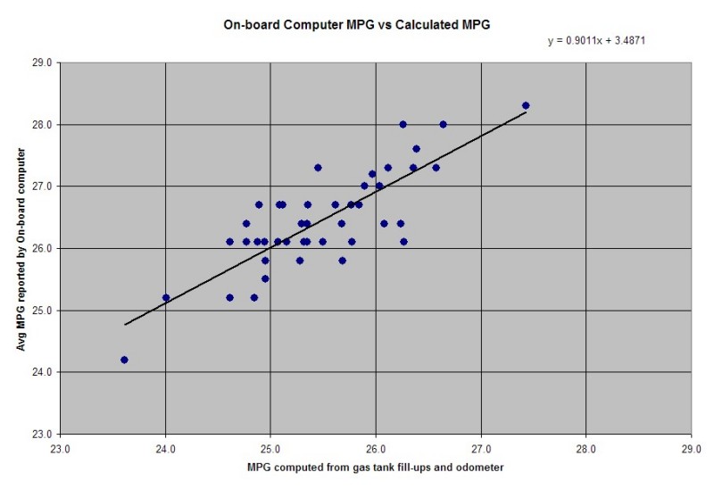

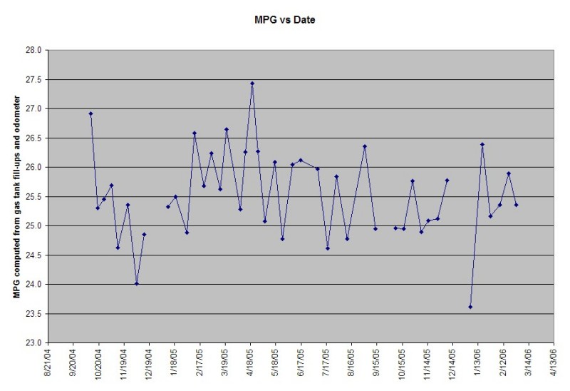

My mileage
2005 MCS. 205-45-17 Pirelli Euforia runflats, 38psi front 35psi rear. 15% reduction supercharger pulley, VGS, balance mechanically stock. Southern California climate. Daily solo commute 20mi each way, ~2/3 surface street, 1/3 freeway. Occasional longer freeway trips. Note discrepancy between OBC avg MPG and MPG computed from odometer and gas pump readings. Also not relationship of MPG to avg speed.
Attached Thumbnails gas mileage, i'm averaging 18.9-19.1 ALL the time, and have-mpgvsdate1.jpg   gas mileage, i'm averaging 18.9-19.1 ALL the time, and have-mpgvsavgmph1.jpg   gas mileage, i'm averaging 18.9-19.1 ALL the time, and have-obcmpgvscalcmpg1.jpg
