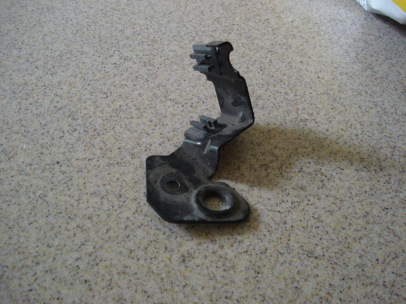

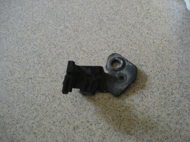

Reached in to see if i could turn the fan by hand today. Look what i found in there keeping the fan from turning. Any ideas of what it is?

Looks like something fell of the car or you picked something up somehow. Weird. Does the fan work now that the foreign object is gone?

I am assuming the mechanic that fixed the hood and bumper dropped it in there. I have no idea where it goes. Any thoughts? I havent dropped the car and drove it yet to see if the fan works. But i bet it burned up the motor.

I bet your right about the motor. It's probably toast. The piece looks like a bracket of some sort. That's a shame and it sounds like it didn't have to happen. Carelessness.
I hope it doesn't cost an arm and a leg. Hopefully no other engine damage either.

That bracket attaches to the frame rail next to the A/C high pressure service port. It holds the wire harness for the fans in place. Probably broke off in the collision and wedged itself in the fan thus burning it up.

Well thats what you think would happen but the bracket has no damage. Thats why i assume the mechanic dropped it in there.
