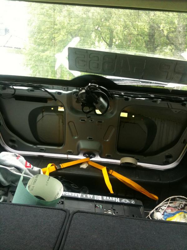

If you use your car daily and don't have time for the primer etc. to dry completly, you can do like this:
The door is covered so dirt and rain won't hit the fresh paint, but be sure to put something in between so that the door won't shut completely. I think you would have a problem opening it again if you shut it without the opening mechanism attached.
On my car I put something between and strapped the door tight so that it couldn't open or shut completly.
