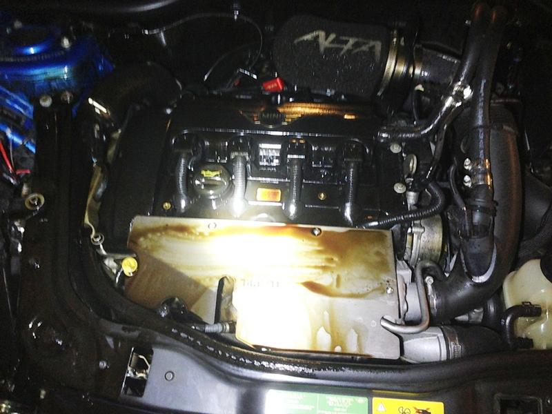

Mine failed yesterday at night. Had a big oil leak 500 meter near my home and a lot of smoke coming from the engine bay. Stopped the car, checked the hood and oil everywhere. Shut down the car and with the help of my brother, we moved the car to my garaje. Towed it today to the dealer and now I'm waiting for news, I hope it's only the chain and just need to change all that parts, the car was running fine
It's a JCW 2011, with 41,000 KM or 25,476 Miles. Always checked the oil every weekend and filled accordly. Last service was at 24,000 miles.
Can you get an idea where its coming from? With all that oil on the front I'd suspect a turbo oil line or something. Or major cracked valve cover. Any funny noises?
If the chain failed it wouldn't be running most likely as timing would be way off and most likely no oil leaks.
I think it's the chain because I had exactly the same problem like Ladybug-S: https://www.northamericanmotoring.co...-oil-leak.html. He/she later replied that the problem was the chain.
Most of the oil came from the dipstik, like there was too much pressure and pop out, because it was out of its place and a big spoot in the hood. The turbo oil lines looked good, but oil was everywhere, very hard to check the posible leak
No funny noises, car was running fine after the oil leak, moved it probably 200 meters or less before the shut down.

Makes sense why it would lose that much oil as its a large hole. However it faces the firewall. Not sure what would cause the differential pressure to force the dipstick up like that though.

Yes, it's very strange. I just hope it's only the chain and the engine is fine.
Have the PCV valve checked. If I'm not mistaken that can cause pressure problems which would potentially cause the dipstick to be forced out.
My '07 just recently had a stuck PCV and the timing chain guide break off into the engine.
These engines are just not good. It will be a miracle to see the R56s on the road in 10 years.
Just to update, like you said, it was the PCV, thanks! Had to buy a new cover, car is running fine now. I'll flash Alta Stage 3 tomorrow and check that the car is running strong again.
By the way, according to the dealer, timming chain is fine (for now ).
