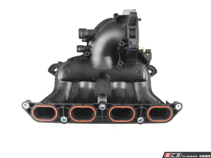

11614584240 That's the cold weather part Cooper S N14. Moisture from short runs ( start and stop ) and oil from the valve cover PVC system then collects on the intake throttle body and when super cold gums up and can crystallize. See this every year when we have sub zero temps. Sometimes it does not get cold enough here in the states.
Either get the Cold weather intake above 11614584240 , which sends the valve cover air right before the cylinder. Or clean out your old one, which you will have to pop it off and the throttle body.
Stock intake Cooper S N14 N18 11617595078
The TIB number is also on that linked page with info. Diagram shows you the hardware and locations. That line above 11157605186 when you have the cold weather intake is removed. as the cold weather has the new version already installed. Just re-clips into that left side( passenger ) valve cover port.

Have not seen it mentioned for that , 13742756043 is the stock part that attaches to the firewall behind it for people with the sound generator N14 engine to -6/2010, JCW -2012. But they also mention the 11614584240 was updated again. Maybe the newer design compensated for the sound tube. All I can see is that the tube comes close to the manifold, but its the same part number as the old one ?
# 16 in the diagram.
Even the 11614584240 has the tab on the upper corner to hold the soundmaker box.

Well I bought the cold weather manifold from ECS Tuning, and had it installed by a free-lance mechanic out of his home garage. The mechanic said it took 4 hours but his rates are really reasonable so it wasn't as expensive as it could have been. He mentioned that it was difficult to remove the old manifold because of the piping and he was worried about breaking the plastic throttle body. He also said there was some strange looking greasy frozen sludge that had to be cleaned out.
So there were no other parts that had to be bought - just the new manifold.
So far no more problems, but it's only been a few days since he installed it, although we have had -20C weather and usually I'd have problems when it's that cold.

Awesome, thanks for the update and the order. That greasy frozen sludge is the oil / water mix that collects from short stop starts and never gets burned off.

The newer intake design keeps the vapor out near the throttle body. A catch can will separate the vapors out. Which then can be drained later on.

The intake just bypasses the vapor past the Throttle body, puts them closer to the ports and combustion area. In very cold areas this prevents the icing of the throttle body. All the info is above. You will have to run the catch can on the other side and not on the bypass CC throttle. Unless you can mock something up, i have not see a CC version intake with a catch can on the same side as the newer design.

My Clubman was fun but it had a few problems such as this intake manifold one. I live in a cold climate for the winter and I it went into limp mode too many times. All I know is that the new intake manifold fixed the problem. Surprised that it wouldn't be an out-of-warranty recall for the car.
