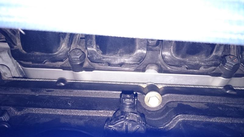

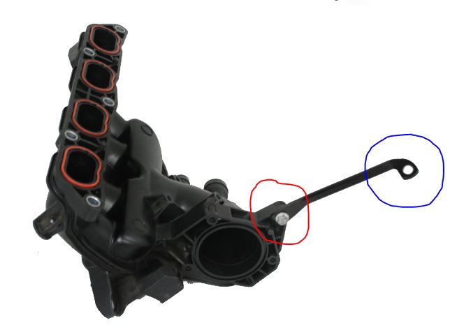

Next was the turbo discharge pipe. This had the 3 hour bolt. In the PDF image, you can see the bolt hole. It attaches on the middle of the fan shroud and is nearly impossible to get to. I would not do this again, nor would I recommend installing any similar piece as no manufacturer makes any power claims from this ("eliminates an OEM power-robbing muffler". After the install, I did hear a bit more intake noises because of this (NM pipe has no silencer), but they weren't cool enough to warrant the pain in the a$$ this thing caused.

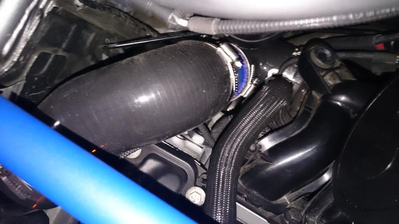

Some additional pics as well. Sorry so dark. Taken at night with cell phone flash...

I had some time last night to do some investigations. Before I started, I plugged a code reader in. No errors, but there were a couple warnings:
O2
Heater
Not really sure what they meant.
Proceeded to tear down piping between CAI and turbo. As I was inspecting the bolts on the BOV I noticed a loose cable under the turbo. Hmmm... why's that there? I plugged it in to a port just under the drivers side of the turbo and declared, "I bet that's the problem!" I believe its #2 in this realoem diagram:
http://realoem.com/bmw/showparts.do?...44&hg=11&fg=50
Decided that while I was in there I would install the boost tap and oil CC. Its shocking how much oil residue is in that system. No wonder I've been walnut blasted 2X in 43K miles. No real issues with the install. In fact, the BSH stuff is very subtle and looks kinda stock. I'll post some pics in a day or two.
Put everything back together (I had removed the OE fresh air line to make room for the CC). Started the car. No CELs, but forgot to check for those other warnings (I'll do that today). Took it for a spin.
Totally different car! I still have the VR Tune, but will flash back to stock, dyno, reflash VR, and dyno again. At this point, the butt dyno says I've gained all my power back and added more. I honestly think the Alta BOV spring makes a huge difference when shifting gears (esp. in the automatic). The car positively surges, lag is minimal and torque steer isn't too bad. From 2-3 and 3-4 under power, the car seems to surge even faster after a gear change (probably due to the turbo's torque curve) - my buddy had the same observation. The BOV no longer sounds like a warbly fart. True Fast n Furious pppffssst, but not quite as high pitched. Honestly, not what I was looking for (I'm too old for that kind of attention), but still makes you giggle a bit.
I'll schedule the dyno and get back to you guys in a few days. If I can find a safe place for some 0-60 runs, I'll try to get before/after tune runs for those as well.
