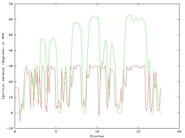

OBD-II datalogger.
Originally Posted by Ryephile
Also, I'm heavily considering buying an OBDII datalogger very soon. Anyone have experience with them, and can offer recommendations?
I use this one ELMscan ISO for $80
I can get charts like this
But I had to write software to perform the captures.
The only parameters you can read directly are these:
PIDs supported by MINI Cooper 2002
Service 1 PIDs
PID Sensor Returned value
00 PIDs supported
01 System tests status
03 Fuel system status
04 Calculated Load Value 0% to 100% 100% = 0xFF
05 Engine Coolant Temp Degree C + 40
06 Short Term Fuel Trim -100% to +99.22% (0% = 0x80)
07 Long Term Fuel Trim -100% to +99.22% (0% = 0x80)
0B Intake Manifold Pressure kPa
0C Engine RPM RPM*4
0D Vehicle Speed KM
0E Ignition Timing Advance 0.5 degree-per-bit 0.0 degree=0x80
0F Air Intake Temperature Degree C + 40
11 Absolute Throttle Position 0%-100% 100%=0xFF
13 Location of O2 sensor
14 O2 Sensor 1 Voltage & Short-term trim -100% to +99.22%
15 O2 Sensor 2 Voltage & Short-term trim -100% to +99.22%
1C OBD standard
20 More PIDs 80000000
21 KM travelled while MIL lit
Andy@rosstech has some other means of reading more values from the onboard computers, and it might be good to check with him.
Were you going to send me a bypass valve to modify?
