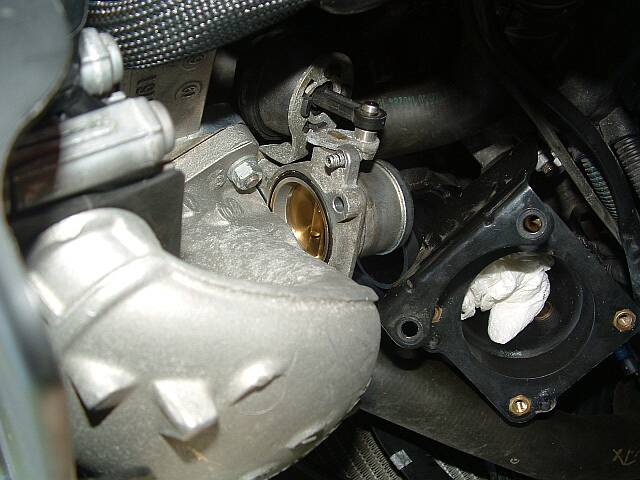

I did some logging with the zip tie method of holding the bypass valve closed and I lost between 3 and 4 psi of boost:

The set screw is just that a screw that rides on a cam that act's as a stop for the position of the bypass valve flap control shaft. It appears to be coated with an anti- vibration material. It should be adjusted without any vacuum/pressure on the unit so that the flap is just closed as Ryan has said.
Can someone explain a bit more clearly how we can adjust this screw to be certain that it's fully closing? Will it be obvious once I get in there whether or not the flap is closing? Will it require any more handiwork than the basic Ryephix #1 instructions?
Also, Ryan, are you still recommending the Ryephix #1 solution?

To "calibrate" the bypass valve to fully closed, I recommend removing it from the vehicle in order to easily visualize its position. Keep in mind all the adjustments from out-the-box are very minimal, and any gain will be marginal.

What is the easiest way to remove the bypass valve?
Old Jun 1, 2004 | 10:01 PM
  #518
Ryephile's Avatar
Ryephile
Joined: Jan 2003
Posts: 9,009
Likes: 36
From: Metro-Detroit
--->CoryB - there is a metal gasket between the intercooler exit bend and the intake manifold, that's it (for the driver side of the engine).
--->Andy - Easy is relative
1) remove the CAI-to-TB tube (you can leave the PCV hose connected and just bend it back out of the way).
2) remove the intercooler
3) remove the intake tubes from the radiator baffle to the lower airbox.
4) remove the IC exit bend. Three nuts (don't lose them in the depths of the engine bay!), loosen the clamps for the bypass valve, and YANK the IC exit bend. Yes, it's scary sounding.
5) remove the three bolts holding the bypass valve to the IC exit bend.
6) drink favorite beverage.
*you do not have to remove the TB. Removal of CAI-to-TB hose is to increase ease-of-operation room. Removal of IC is ease YANK operation.

Since I never like to follow directions, I am going to try to remove the BPV by removing the HAI and the throttle body. If that doesn't work, I'll definitely go to plan R.

I got the bypass valve removed ... well, I left one bolt in place, and just rotated the valve so I could see the butterfly actuation. It appears to be fully closed when it is against the stop. Also, it does not overshoot in operation:
