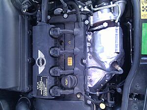

So I just got home from picking my car up at Mountain View Mini. In addition to periodic maintenance they did the timing change tensioner fix. Unfortunately on the way home I noticed the check engine light was lit.
Two problems:
* My OBD2 reader says the CEL code is P1497. Any guesses to what this is? Searching the forums only list it as 'BMW specific.' I'm not super excited about having to go all they way back there after three days sans car.
* I can't remember if the R56 has a removable plastic fascia on top of the engine. My memory says yes, but I might be mixing that up with my old car. Should my R56 have a plastic MINI branded cover over the spark plugs?

The engine bay looks about right.
Thanks! - I had strange car deja vu.
