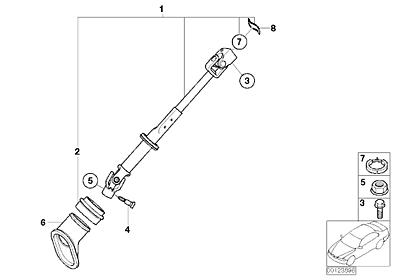

vodka's Avatar
vodka
Joined: Oct 2006
Posts: 239
Hi,
Do you have the part number or photo for easier to know which part?
Or are those part u refered is in the photo? Which number?
Originally Posted by minitech829
it's not the whole steering column. just the lower shaft. i'm not sure the cost of the part but we charge 2 hours labor for the job (which is like $250 in my area).
Attached Thumbnails Hard steering-NOT THE PUMP! Help-149.jpg   Hard steering-NOT THE PUMP! Help-181.jpg
Old Jun 14, 2010 | 10:42 AM
minitech829's Avatar
minitech829
Joined: Jun 2010
Posts: 30
^^^ hey Vodka, it's the 2nd pic. that whole part. #1. the round thing at the end is the boot i was talking about where the shaft goes through the firewall.
see how there is a u-joint at the end? that's what gets worn out and causes the notchy steering while turning.

Took the Mini to work yesterday. The hard steering is worse than ever. It would seem that there was no problem with my old steering pump. If anyone is interested in buying it, I'm going to hold off a few days before returning it for the core fee. I'll be taking the lower steering column out tomorrow. I hope that is the problem, though I'm not getting my hopes up. I have a bad feeling that the pinion may be bad. Does that sound possible?
Old Jun 16, 2010 | 09:32 AM
molezooka's Avatar
molezooka
Joined: Feb 2009
Posts: 20
I removed the lower steering column today and MiniTech you were right, half the u-joint was seized. I managed to free it up and reinstalled it. The hardest part of it was re-installing that rubber boot. I will be looking for a new lower steering column as I don't trust this one not to seize up again. Minitech I wish I had heard from you before I bought a new pump. Thanks for your help on this problem.
