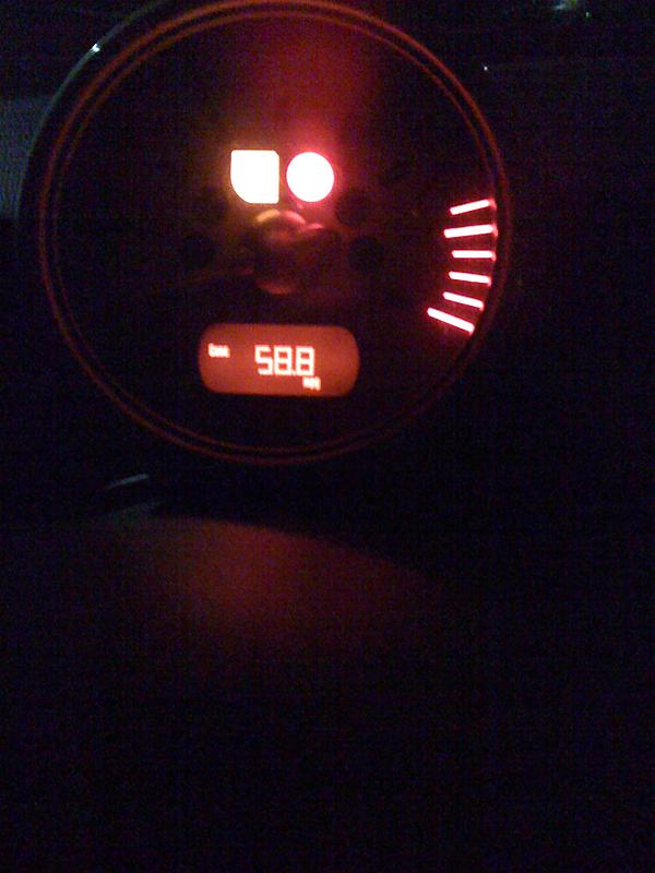

Coming home tonight, my Mini(non-S) went into limp mode. Atleast thats what I think it is: Service engine soon light came on DSC light came on(Constant). Anyways the Service engine light would be solid and blink when the engine shuddered(when it was pulling the timing?).

ohh and the MPG was showing 58.8 MPG(I wish!) haha
