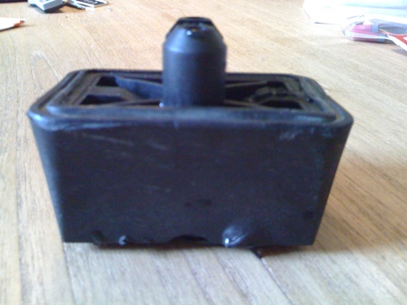

When I was jacking up my car for the first time I managed to pop off the rubber block "thingy" at the jack points. Is there any hope of reattaching it?
I also worry about water getting up in the frame, but maybe I'm obsessing.
Any thoughts are appreciated.

It's not a problem. Just look underneith your frame rail where your "thingy popped off" and find the hole. Then just push it back in place by pushing that little thingy on top of your thingy into the hole. LOL once you have it started you can use your Jack for extra pressure if needed. It will just pop back into place.

I tried, but the hole is too, ahem, loose and it just falls out.

LMAO!!!! You must have bent the hole a bit. If it were me, I'd try to use a moly bolt of some type. You can get them at a hardware store. It's basically a piece of metal that looks like a hinge kind of. It colapses as you push it through the hole and opens back up on the inside to give you a base to screw into. You would then drive a bolt through your jackplate "thingy" and into the moly that is now inside your frame rail. Wow, as simple as that is I think I just confused myself with my own explanation.

My solution was "Gorilla glue", and leave it jacked up in there for an hour. The thing is solidly attached now.

Are you sure the hole is loose or is your thingy too small?

Its meant to take load straight up, not at an angle. You probably put load on it on an angle. You need to push the pin underneath from the center to spread the legs to grab onto the frame rail. Don't glue it, thats a terrible idea.
Its only a $23 part from thee dealer.
Its called a jack point.
