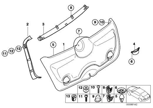

If you don't see the connector you may have to take off the plastic panel off the hatch, in fact that's what I did because I couldn't see the connector and it was easier to clean it like that. Some cars came with a longer harness I guess since not everyone had to do this.

This is the panel that I took off in order to gain access to the connector # 1 on the diagram

Much appreciated MINIBX-- honestly had not thought about that to get to the harness. Got the hatch release working again (as posted by others-- connectors needed some deep cleaning).
