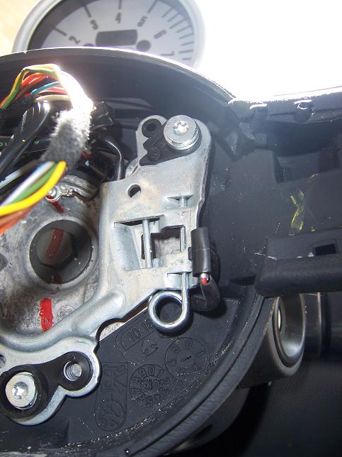

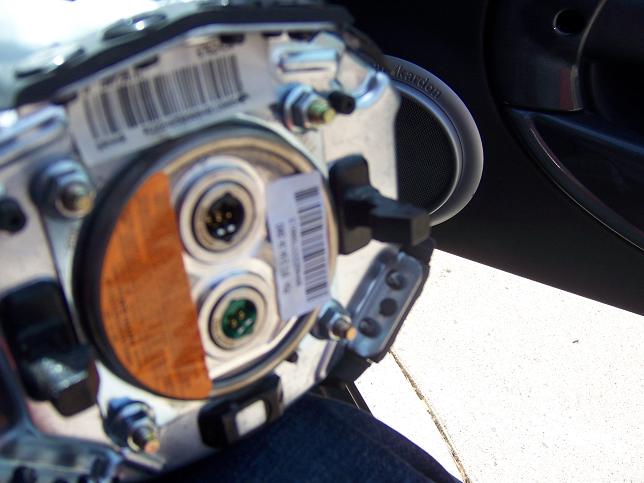

I've attached a few pics. Hopefully they will help someone else. The first picture is the back of the airbag, it has hook type things that hold it in. The second picture somewhat shows the spring that you have to push against. The third picture I tried to show how you have to go in with the torx(best bet) to push on the spring. If you see the little hole to the left of the left side of the spring, thats how far past you have to push the spring to get the airbag off. If anyone has any questions send me a message and I can try to help you.
