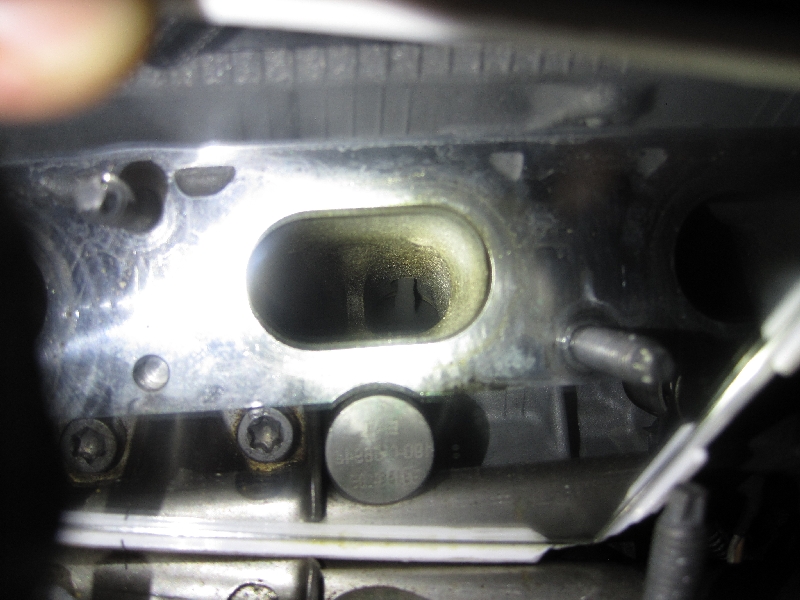

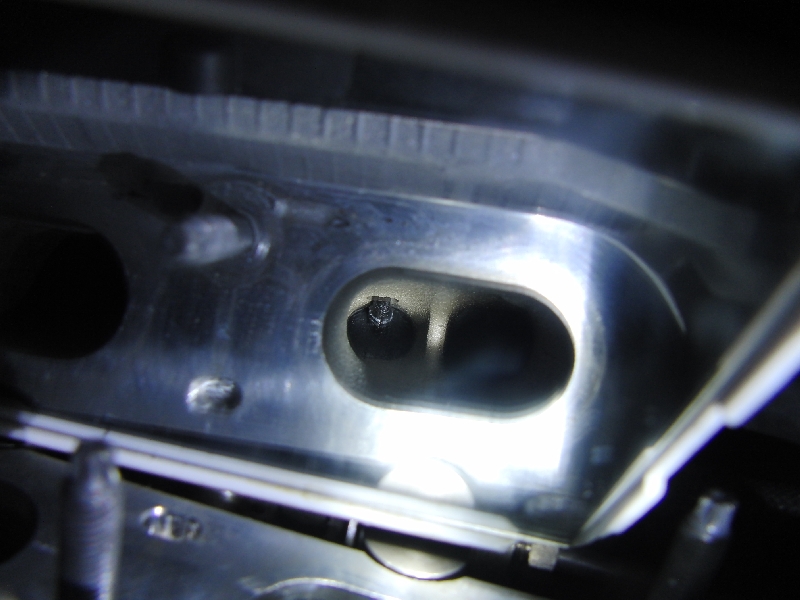

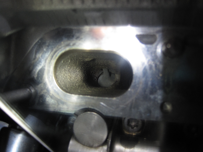

So here are the intake valves for cylinders 1,2 and 4. 3 looked about the same as 1 and 2 so I skipped it. This is the reman engine after 5,000 miles and 1 can of Seafoam through the PCV hose. With the exception of the one valve on cylinder 4, everything looks pretty clean. After seeing the buildup remaining on #4 I'm not sure about the efficacy of Seafoam. I'll check it again in 5,000 more miles.
Attached Thumbnails Recurring Engine Carbon Buildup Problem-cyl-1-2-.jpg   Recurring Engine Carbon Buildup Problem-cyl-2-5-.jpg   Recurring Engine Carbon Buildup Problem-cyl-4-3-.jpg

Nice pics! Thanks for the legwork.
I've been waiting for my warranty to run out before I touch the engine (if carbon buildup ends up lighting the CEL, I don't want any excuses from the dealer on fixing it), but I might as well ask ahead of time… can the intake manifold gaskets be re-used, or do they have to be replaced once the part is disconnected from the head?
I just re-used them. Just have to be careful they don't fall out or get any dirt on them. It didn't even look like any kind of sealant was used. AFAIK just to take a look down at the valves there are no consumables (unless you accidentally lose or break something).
If you are careful and don't damage anything I don't think the dealer will know you opened it up for a peek. When I first started taking it apart I noticed that over the years the dealer had broken or lost non-essential bits and pieces.
What's the mileage currently?
79,000 on the car. 5,000 on the engine.

Wow....5,000 miles and it's that dirty on #4! Time for the BSH catch can and boost tap!
