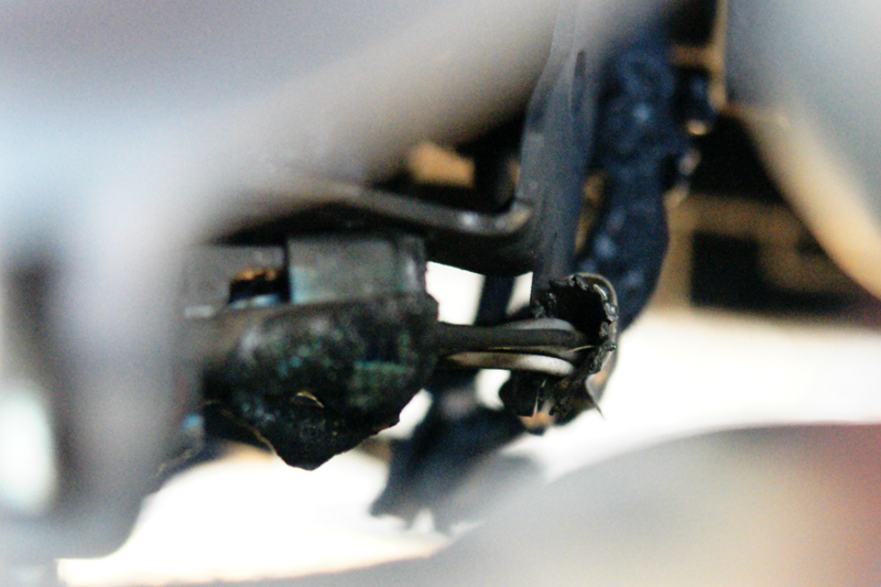

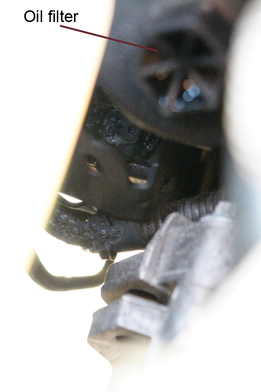

Hi, my 08 MCS caught on fire on Thursday. I was able to put it off with a bottle of water, so no major damage on the car engine (I bet it still starts).
I think that it was the two wires and the wire harness that connects with something just below the oil filter (when I opened the hood they were red hot while it was still smoking - and I bet the smoke was the plastic melting/starting to burn).
It was really fast like Carlisle and Shadowgram's case. Car had been sitting outside of my office for 8-9 hrs, then I drove it for 0.8 miles and on the first traffic light a guy told me about smoke coming out of the hood, went to closest parking lot, opened hood, it was only smoke, I run to get fire extinguisher/water... and when I got back (took me a minute or two to get a small bottle of water) there were flames touching the air intake pipe (by the turbo).
I hope that MINI gets good conclusions after studying my car. You can see where it burned, but the wires and the harness are still there (easy to study for a fire expert).

I want to look around under the the oil filter and see the area you mention. Please update with the parts that are replaced and maybe we can check the same in our Minis.

Looks like I had better buy an extinguisher. Pisco has some evidence to a possible source. Can someone get a schematic and see what this circuit is? BMW should be doing some analysis on this.
Is their any trend on which area it seems to start from?
Wires don't overheat by themselves. Sounds like some of these fires happen with the car off. That means a circuit that has power with the car off. A lot these days. To reduce weight and cost, wire sizes are as small as they can possibly het away with it, so it could be something is not fused correctly for whatever fault is causing the higher than expected load. Or, some damage is happening. Does not sound like the latter.
If we have a trend, the NTSB should be contacted. Fire would be considered a safety issue. I am sure BMW would rather investigate and recall if there is a defect, than pay the cost and publicity of someone burning up in their car for a known fault. See what delaying known faults repairs did to Toyota!

Today I picked up my Mini, but I'm still not happy (and I guess you guys should't be either).
The cause of the fire was: auxiliary water pump had a short circuit and apparently this caused the wires to got red hot and the wire harness got on fire.
My dealer fixed my car by replacing the aux water pump and all the wires that burnt, the even offered a loaner car that I didn't take.
Dealer can not change the "engineering" so they are limited to replacing what was damaged. I have contacted Mini USA to see if they want to use my car as a guinea pig, study, investigate, add a fuse so it burns instead of burning the car but I don't think that they are very interested. I spoke with the "escalating affairs" contact yesterday, and he said that I would get a call back but 25 hours later and there has been no call (I guess that mini on fire is not a priority!)
