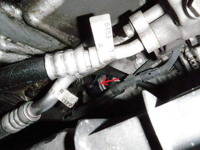

Hi all,
I just picked up a 04 S with 90k on clock and need some input/feedback on identifying a very slight oil leak. Slight meaning its just damp and it never hits the ground even when its parked for 3 days straight in my garage. The tech who replaced my front motor mount noticed the leak and suggested that it might be the o-ring and a big (meaning expensive) job. I will get it fixed if that is the issue but would like some other opinion before I open my wallet.
Hitsory: The previous owner had the oil pan gasket replaced at 85K (with receipt) and oil changed 1k miles ago. Overall, the car is in great shape per the tech who replaced my front motor mount.
Thank you in advance.
Below is a photo of where the leak is coming from.

Crank sensor seal?

Thanks. I took a photo again and it seems like its coming from the front of the block. There is also a green (coolant like) slimy fluid that is mixed with oil. I checked my oil and coolant level and both seems to be fine.
If anyone can tell what parts should I replace its greatly appreciated.

since the wind blows the oil around so much....its tough to track don leaks in a photo...they can take some real detective work. While you are at it, check your PS fluid level.
What color is your coolant....BMW/MINI fluid is blue.....

The leak only happens after a drive. I gave it a good wipe 4 days ago and it sat in the garage for 4 days with no leaks. PS level is fine and my coolant looks green inside the reservoir but clear when on my finger. The substance feels slimey/oily and not watery.

If I had to bet $$, my guess is you might have 2 problems...a slight oil leak....just keep an eye on it....and a leaking thermostat. The thermostats leak is pretty common...a revised part is available from MINI with a better gasket. The oil leak....could be a few different places....but you said oil levels are fine and it it leaks a little bit....so Just keep an eye on it. Sometime when you have other work done, you will likely find the source....and can get it taken care of. Just remember to check your oil.

Thanks. I removed the plastic pan and took a better photo. The oil and coolant leak seems to be coming directly below the SC. I hope its not the water pump..

The coolant leak is coming from the water pump. At 90,000 miles, It is time to replace it, do the thermostat at the same time and only use BMW or MINI branded coolant. Prestone does not have the silicates that BMW likes in their engines. The oil leak is two fold. While the water pump is out, replace the o-ring on the crank sensor, it is leaking. I have also found the some typical leaking occurs from the upper and lower block seam. I only worry about tightening the outer ladder assembly bolts when the oil pan is removed.

Are you sure its not the valve cover gasket?

Dan knows what he's talking about here. He replaced my water pump and crank sensor o-ring a month or so back. I also have a slightly weepy oil pan gasket (again) but am going to wait a while to fix that.
And my thermostat gasket was replace a couple of years ago.

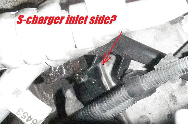

Is this what your taking about?
I just changed my oil and the next morning I noticed a small amount of oil on my garage floor. The leak is coming from the S charger inlet. Is that right? How do I fix this? Is there a "how to" on it? It is almost as if the boot attached to the S-charger is not on all of the way?
Old May 31, 2010 | 01:15 PM
DMBFan2's Avatar
DMBFan2
Joined: Jul 2009
Posts: 385
Heres a close up.
